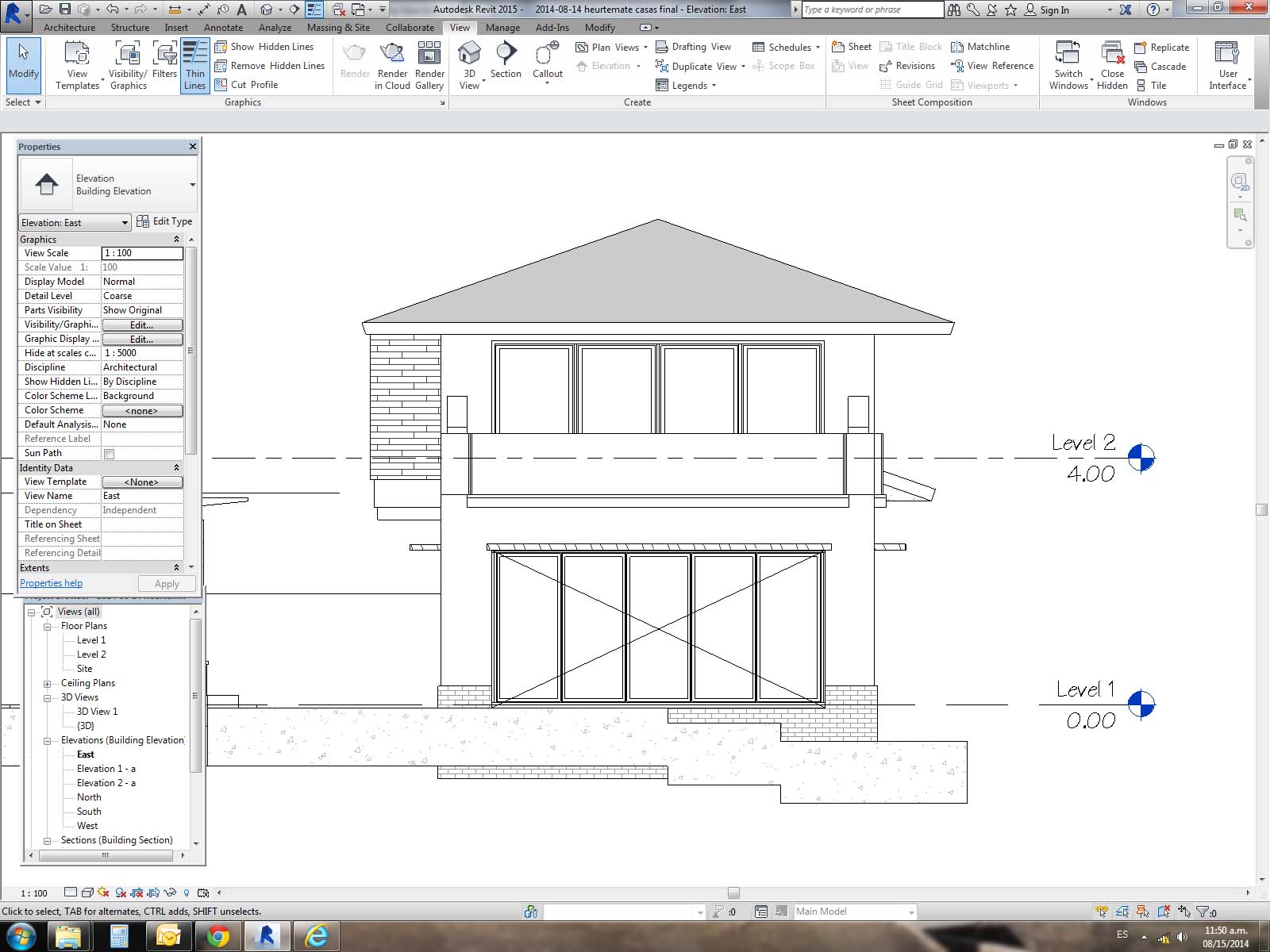

hi!
i am using revit 2015
i have been working with this project for some time know, and somehow the level went from 3,40 to 4 m
all the walls, floors and elements of this level have know an base offset of -0.60m
how can i change my level back to 3,40 without having to configurate all the elements???

an print screen

Relocate your project
http://help.autodesk.com/view/RVT/2015/ENU/?guid=GUID-87EC952E-2B13-4246-9F40-C78F4A642619
