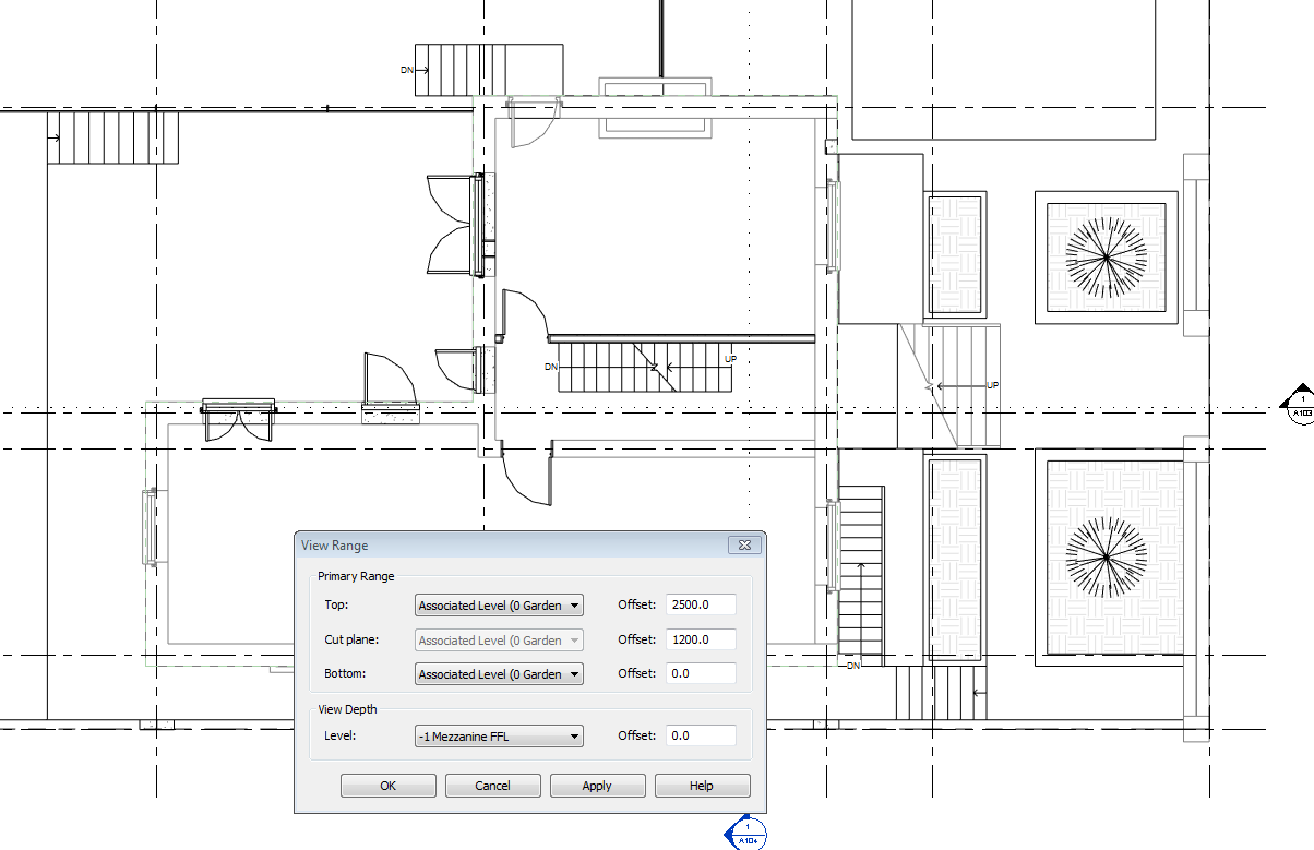

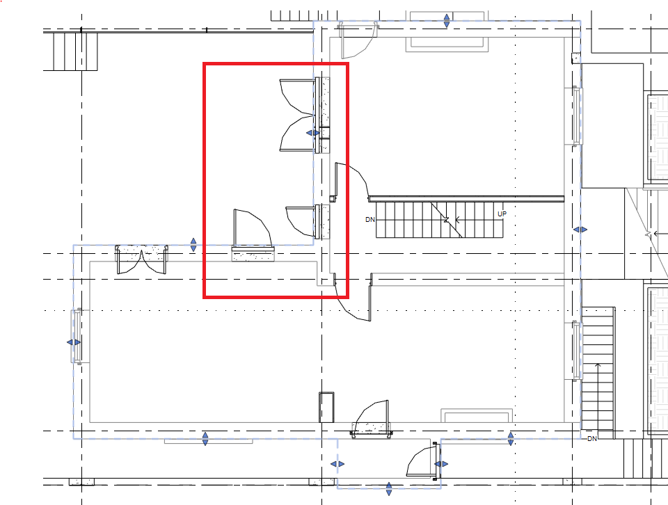

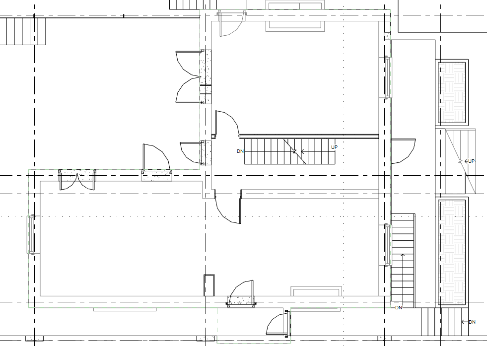

I think that Plan Region is a great feature, but doesn't look like I understand it 100%.
My Ground level outside the house is 0, house's Lower Ground finish floor level is -1440. I want to have a cut section 1200mm above surfaces. So, in Ground Level view, I used Plan Region arround the house's perimeter, edited View Range. It seems that it helped, but still doesn't show it correctly.
Second thing is, when I adjust the Main View Range, it affects Plan Region area too!
Please find 2x pictures attached showing door frames.
Thank you.

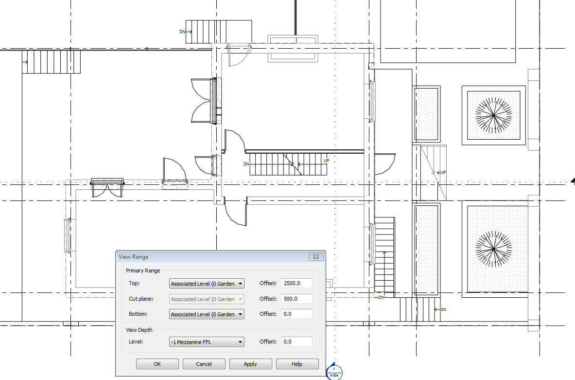

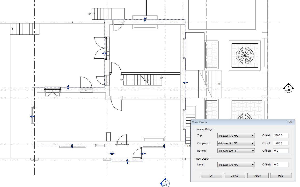

Please find attached.
1. Main View Range 1200
2. Main View range 500
3. Plan Region View Range
I hope it helps!

I suggest you make all of your settings from the level of the view like maybe this if I somewhat understand you.... an elevation with linework to show us the ranges you want sure would have helped)
  • Ground Level - Top 2200, cut 1200, bottom 0 (all associated ground level)
  • Plan Region - Top -240, cut -1440, bottom -2200 (all associated ground level)

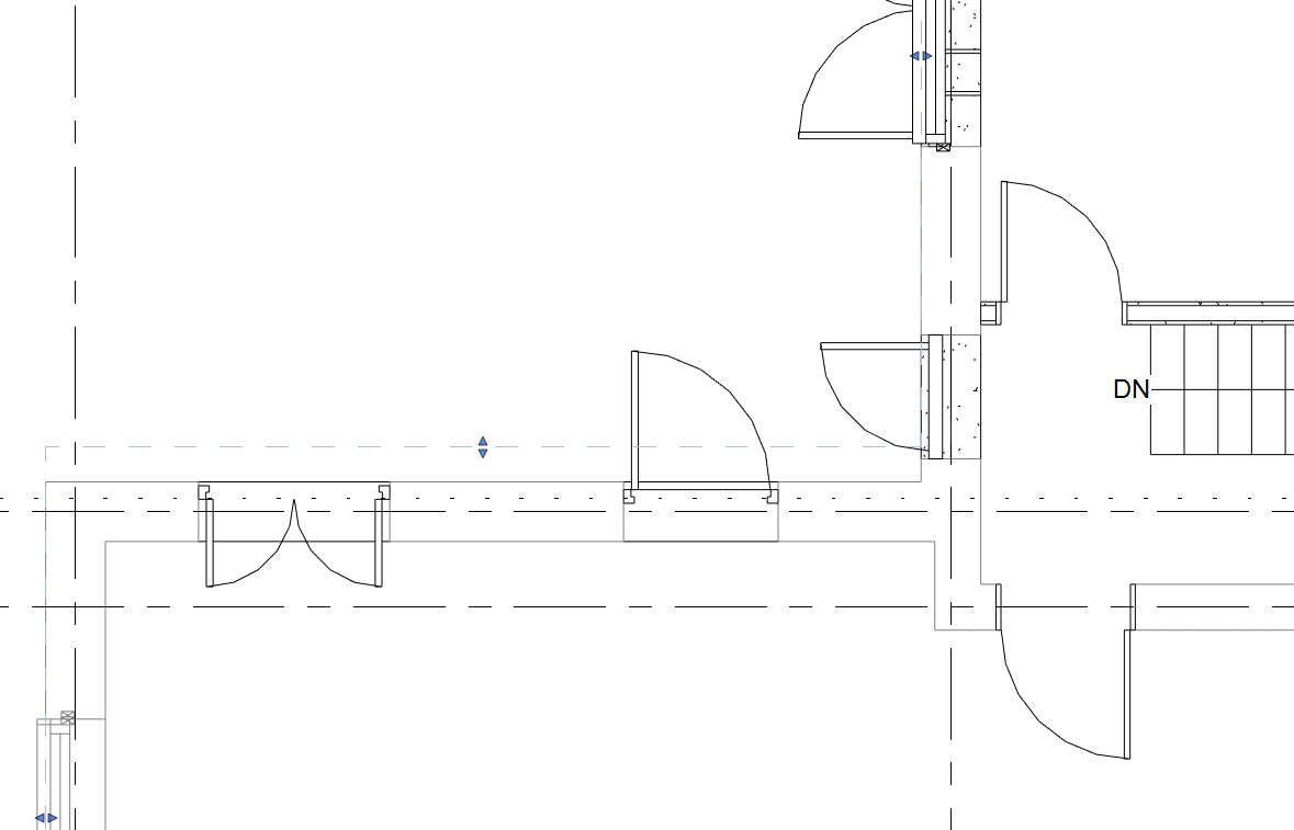

I found out that I have to move my Plan Region Line about 250mm away from the House Outer line in order to show the door frame correctly. I believe it is because Door Swing is overlapping the Plan Region Boundary line. That doesn't solve my problem, as I want Plan Region line no to go further than the house's outer line.
Garden House Level is 0.
Lower ground FFL is -1440.
The main view is Garden House Level, and I want to include Lower Ground FFL in it.
