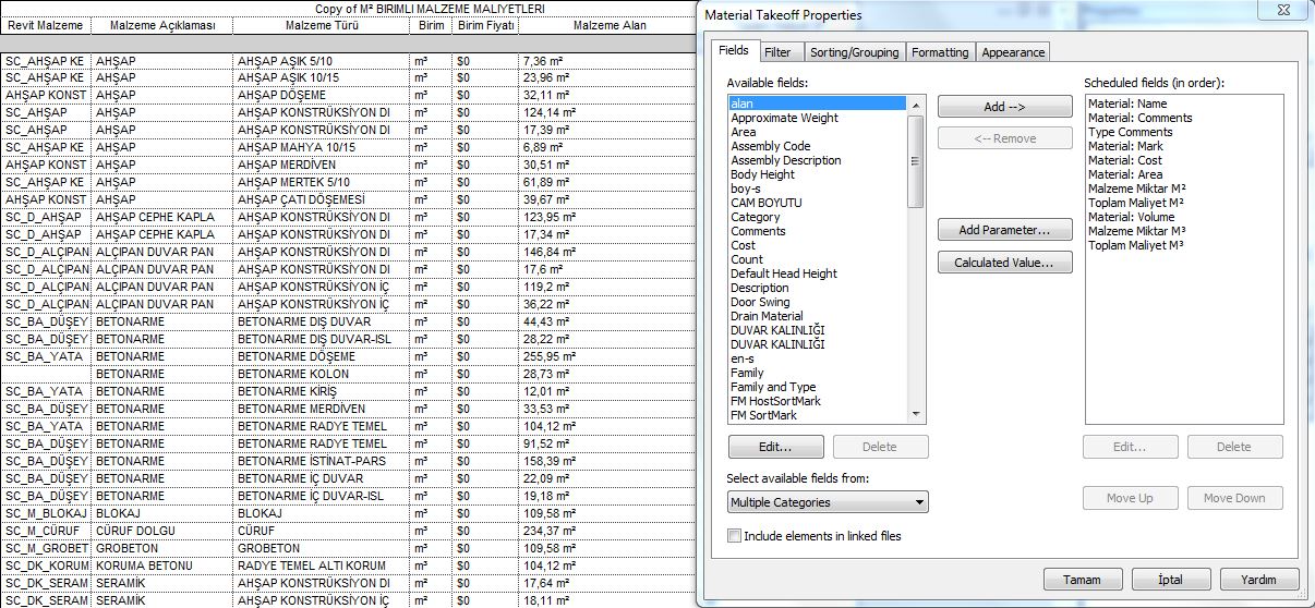

Hi,I am trying to calculate different calculations according to "Material: Mark". For example, i have 2 materials whose marks are "" and "". I want it to calculate ParameterA*ParameterB if mark is and vice versa.But when i click OK, it says "m² is not a valid schedule field." Here is my IF statement:      IF (Material: Mark = m², "ParameterA*ParameterB", "ParameterC*ParameterD")             Any suggestion?

 I did read actually. Still couldn't figure it out. My condition is being m² or being m³. But it says, "the following is not a valid schedule field : m²"

Thank you very much for your patience Smile Yes, it is text. But it doesn't matter if it is m³ or ABC. It is still saying "not valid schedule field."  If it is not too much to ask; could you please write it for me to try? What i want is, if "Material: Mark" is "m²", it should multiply "Malzeme Miktar M²" and "Material: Cost". If it is not "m²" (or if it is "m³"), it should multiply "Malzeme Miktar M³" and "Material: Cost".  Thanks by now.

Oh no no. Multiply ones are already regular numbers. I misunderstood you, sorry. I suppose i have to duplicate material cost too ( i forgot this, yeap) as numbers and change special characters in material mark. Thanks for your help! (i am trying to read, reply and understand while i am on my phone and in a crowded bus Smile i accidently pressed and reported your previous message as offensive. Sorry about that too. Smile )   Gosh what a terrible day!
