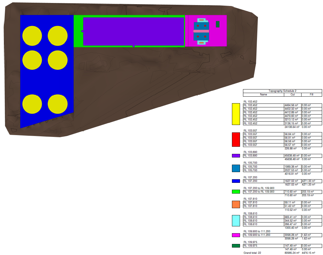

hi.
1. override and viewport filter is the only way to change color (i only tried overide)
2. assign a mark, comment, or name to differentiate every color
3. run schedule and include mark comment name etc etc
3. create a legend view and use filled region for the different colors
see attached file for your referrence

So we have to achieve this legend idea manually. Will do.
