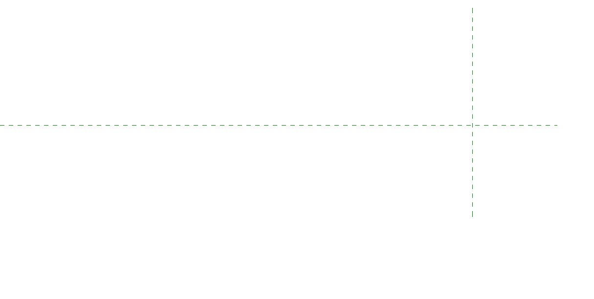

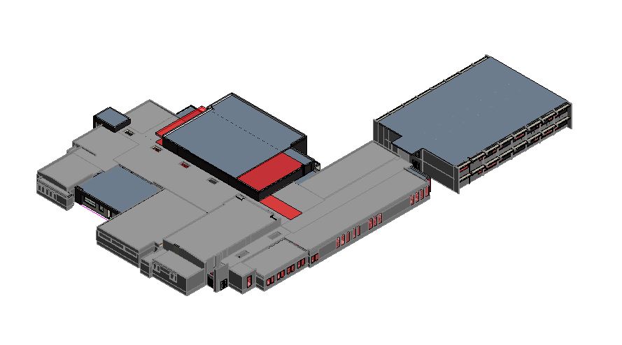

I've searched for an answer to this one for a couple hours now, and found nothing. I have a linked model that is showing just fine in the 3D view, but won't show up in any other view. I've attached a screen shot of the two views (3D and Plan) for comparison. I've already opened the linked model to check a few things. They are NOT using worksharing. The phase settings have not been changed from the stock "Existing" and "New Construction", so those match in my model as well. I checked the VG settings in my plan view. The linked model is set to show. I checked the "manage linked models" settings, it is set to show there as well. I'm stumped. Anyone got some ideas?

Your image doesn't mean much.  Is this whole thing the linked file or just part of it?  Always mark up your posted image using paint or something else to tell us what is going on.
I'm going to assume that this whole thing is the link.  That being the case, go to an elevation view, uncrop it and type ZA.  (Try other elevations if necessary)  I will bet this linked building is well above or below your plan levels.

WWhub - Sorry, yes the entire thing is the linked model. I did create an elevation to check and see if it was "up in the air". Nope. And when I open the linked model, the main floor is set to 0'-0" elevation, just like my floor plan is. If I create any sort of elevation or section, then open it and zoom to extents, all I see are the two work planes from the linked model, just like the plan view.

If your elevation doesn't intersect the linked model then you still will not see it.  Your elevation may even be looking away from the linked model.  The linked model's floor elevation of 0,0 has nothing to do with your floor elevation of 0,0.  This kind of problem may be hard for you to ferret out but here is a way to see where the element is vertically:
  1. Open the 3D view where you see the model
  2. Along the bottom of the screen , find the house icon with the lock and click on it.  (This locks the view)
  3. Name it
  4. Now from the annotation tab, pick spot elevation from the dimension tab
  5. pick the bottom of a wall ( I am assuming your tag is set to relative - current level - if not then come back)
  6. What elevation is it.  Typically the base of the wall would be first floor - thus 0'-0"
If it's not 0-0 then it will show you where it is vertically.

That's a pretty sweet trick that I did not know! Thank you. Apparently the linked model was 9'-10" above my plan view. It threw me off because when I opened the linked model, "Finished Floor" was set to 0'-0". And you were correct, my elevaton view I tried to create was looking away from the building. Doh!
