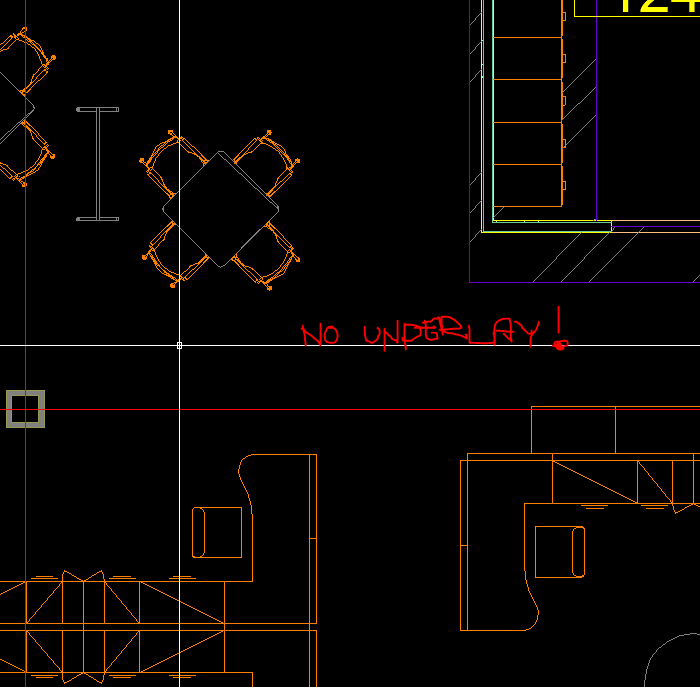

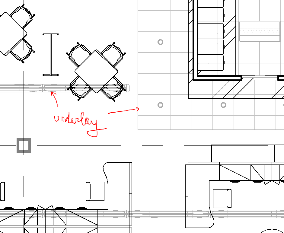

So my firm is unfortunately still using ACAD along with Revit and there is a need to have a floor plan exported into dwg format with the reflected ceiling underlay in the ACAD plan as one dwg. Is there a way to do this? I have tried everything that I know of and it will not export the RCP underlay with the rest of the floor plan even though the underlay is turned on correctly in the view I am exporting.

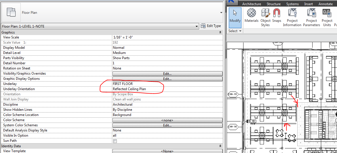

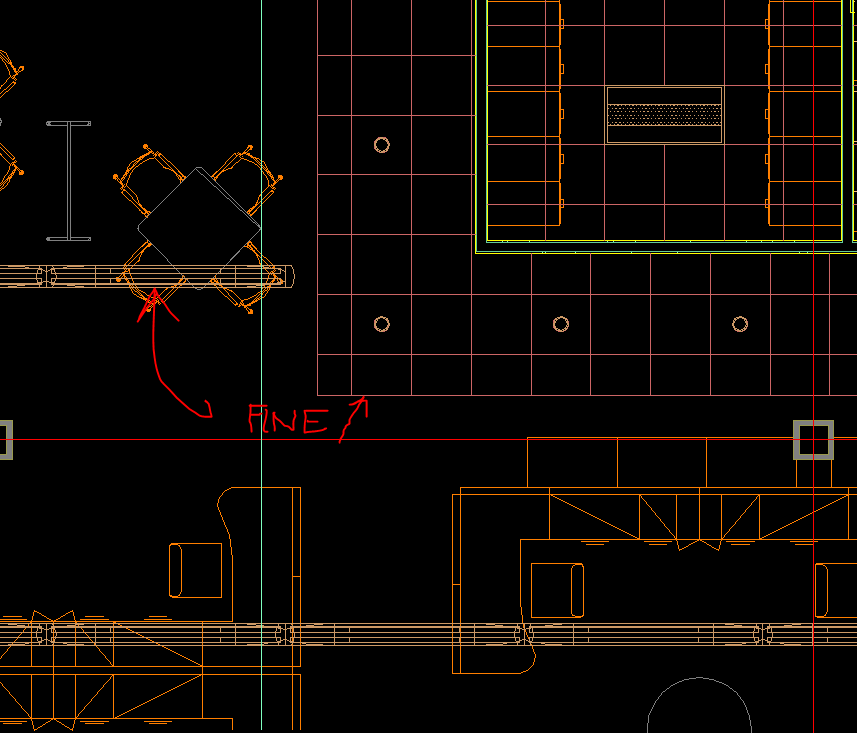

Thanks for that, but I know how the underlays work in general. You are absolutley correct in saying that I am underlaying the FIRST FLOOR, not the FIRST FLOOR RCP. However I am underlaying the FIRST FLOOR level from the RCP perspective when using the Reflected Ceiling Plan underlay orientation setting which in turn underlays the RCP information. I just so happen to say that by doing this I am technically underlaying my RCP into my Floor Plan.
Now that all being said, my problem is that I cannot get the FIRST FLOOR plan in the Reflected Ceiling Plan underlay orientation to export with the floor plan. In the images I uploaded of screenshots you can see its there on the screen the way I want it to export but when actually doing the export the ceiling items do not come through like the view shows. Its weird how i can open a RCP and underlay the FIRST FLOOR plan in Floor Plan underlay orientation into it and then export and everything comes through fine. The problem with that is I cannot get the foundations easily with just the view range since the native RCP's view is oriented from bottom to top whereas the floor plan orientation of underlay is top to bottom.

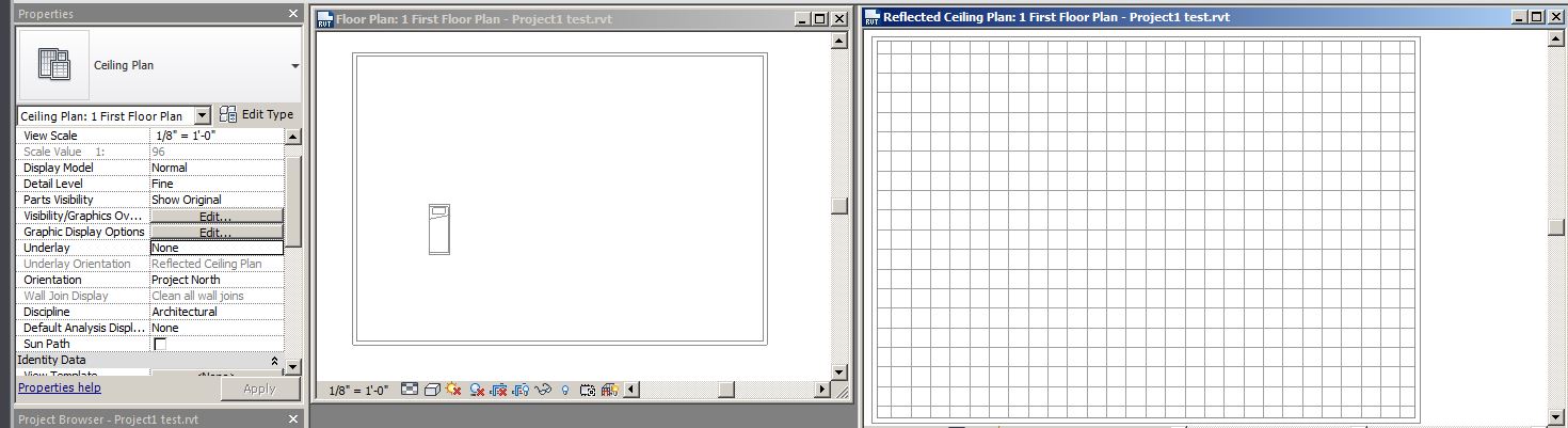

I have no problem exporting a RCP with the floor plan underlay showing.
In the attached, the bed is on the floor plan and does not show up in the RCP.  NO underlay.  I turned underlay on and exported as you can see in attached CAD.
