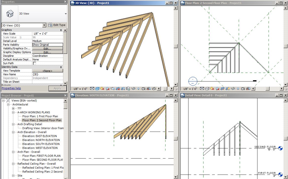

Tue, Aug 12, 2014 at 12:44:28 PM | Drawing a hip rafter in massing
The image below was all done using beams cut by reference planes.
Note.... Rotate your view to work normally with the hips vs the normal rafters.
