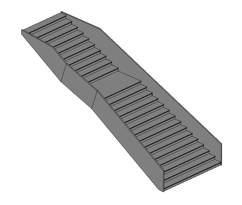

I drew these stairs in the traditional way by drawing the run with the borders and such already figured out. The stairs tapper as the go up and have a landing in the middle of the stairs. The stringers need to run parallel with the stairs, but I can't figure out how to get the stringer to go horizontal at the landing and then pick up the slope again. These are exisiting stairs that we are putting an addition below for. I need help for my office. I am using Revit 2014. The left side is somewhat of what I want, but it's not horizontal. I can't figure it out
Wed, Jul 30, 2014 at 3:50:55 PM | Help with stringers with landing
ericlovell
Joined: Mon, May 10, 2010
14 Posts
I also need the stringer to extend past the stairs at the top. I am not sure if it needs to be more of a railing or a stringer, but it needs to got above and below the actual stairs themselves so I did a stringer.

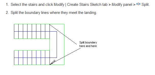

Thu, Jul 31, 2014 at 7:15:17 AM | Help with stringers with landing
Read your HELP again:
http://help.autodesk.com/view/RVT/2015/ENU/?guid=GUID-6C4F7A35-F62B-49A4-92C4-73E9610CA6C8
and you will see this:
Stair Stringer connections
