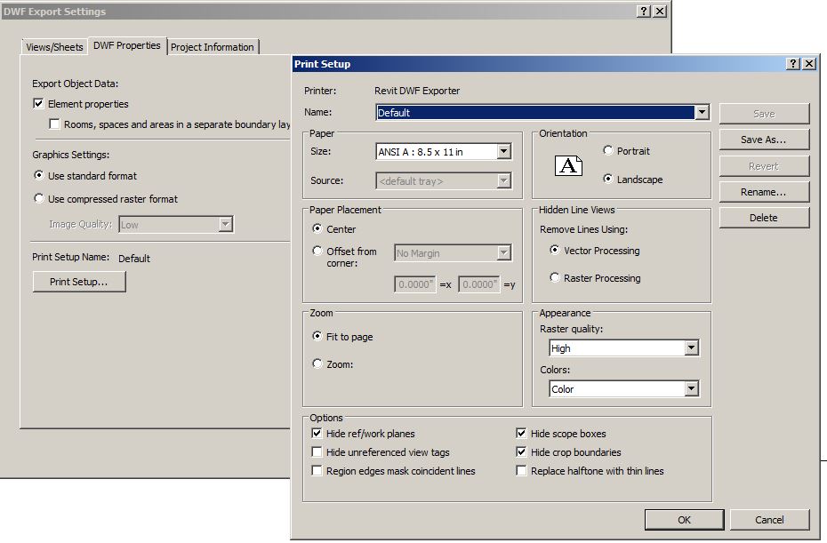

When I export a 3D view to a DWFx the file size is about 36MB. Other individuals can export the same view, from the same model, using the same settings and the file size is less than 5MB. What am I missing?

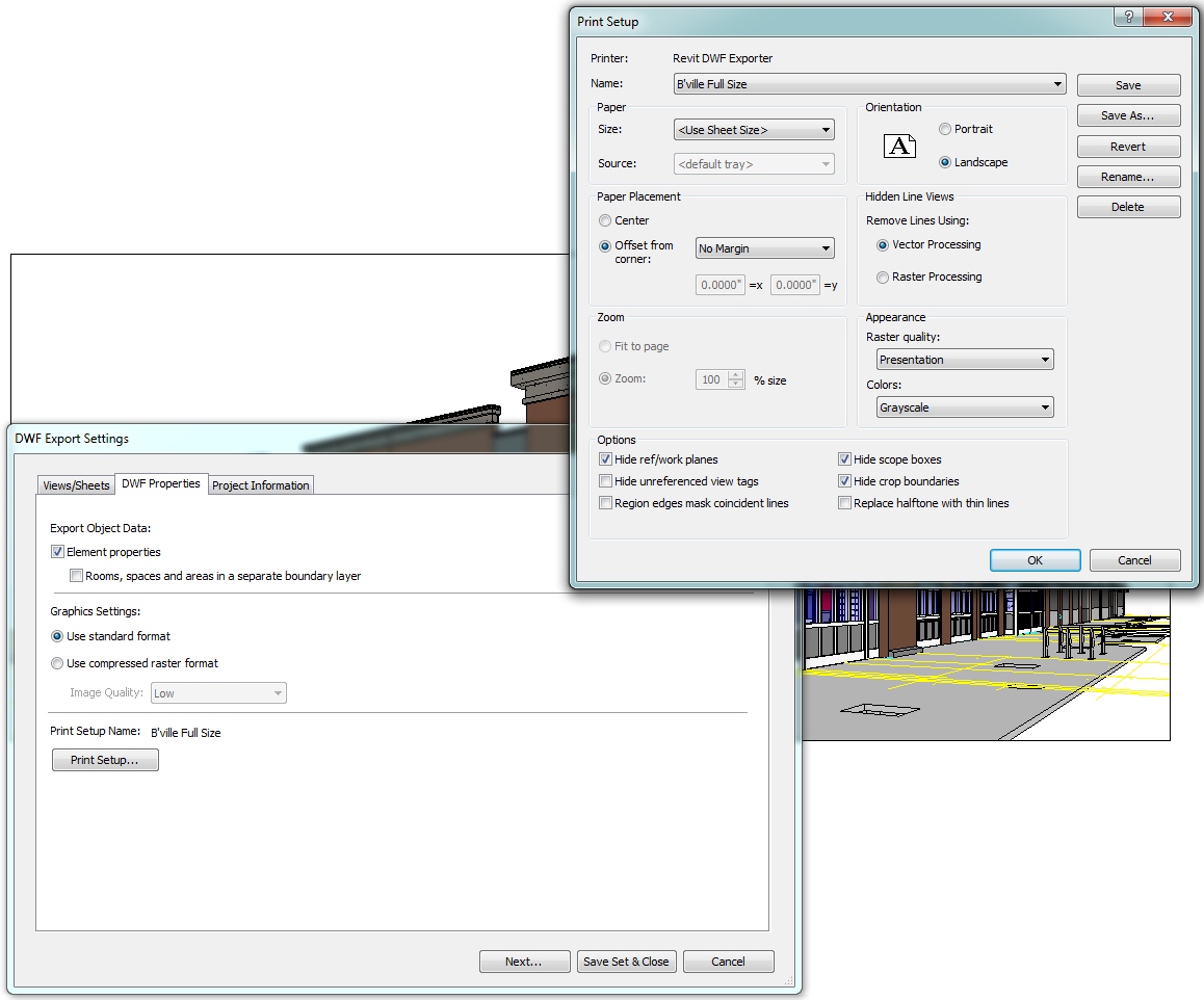

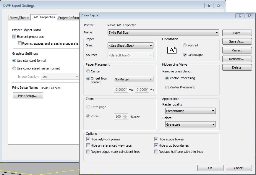

Don't worry, not upset, I understand.  I'm not really new to the site...just haven't needed to post anything.  This is the first issue in the last 5 years that I haven't been able to figure out on my own or thru web research.  I have attached images of the export settings from both computers.

The only thing I can see here is a possibility of the sheet size setting.  I assume this is a view and not a sheet.  Hard set the size or maybe better, place the view on a sheet.  It will probably make no difference but I don't like potential variables.  Also, since you are doing greyscale, you might change the printing to raster.
