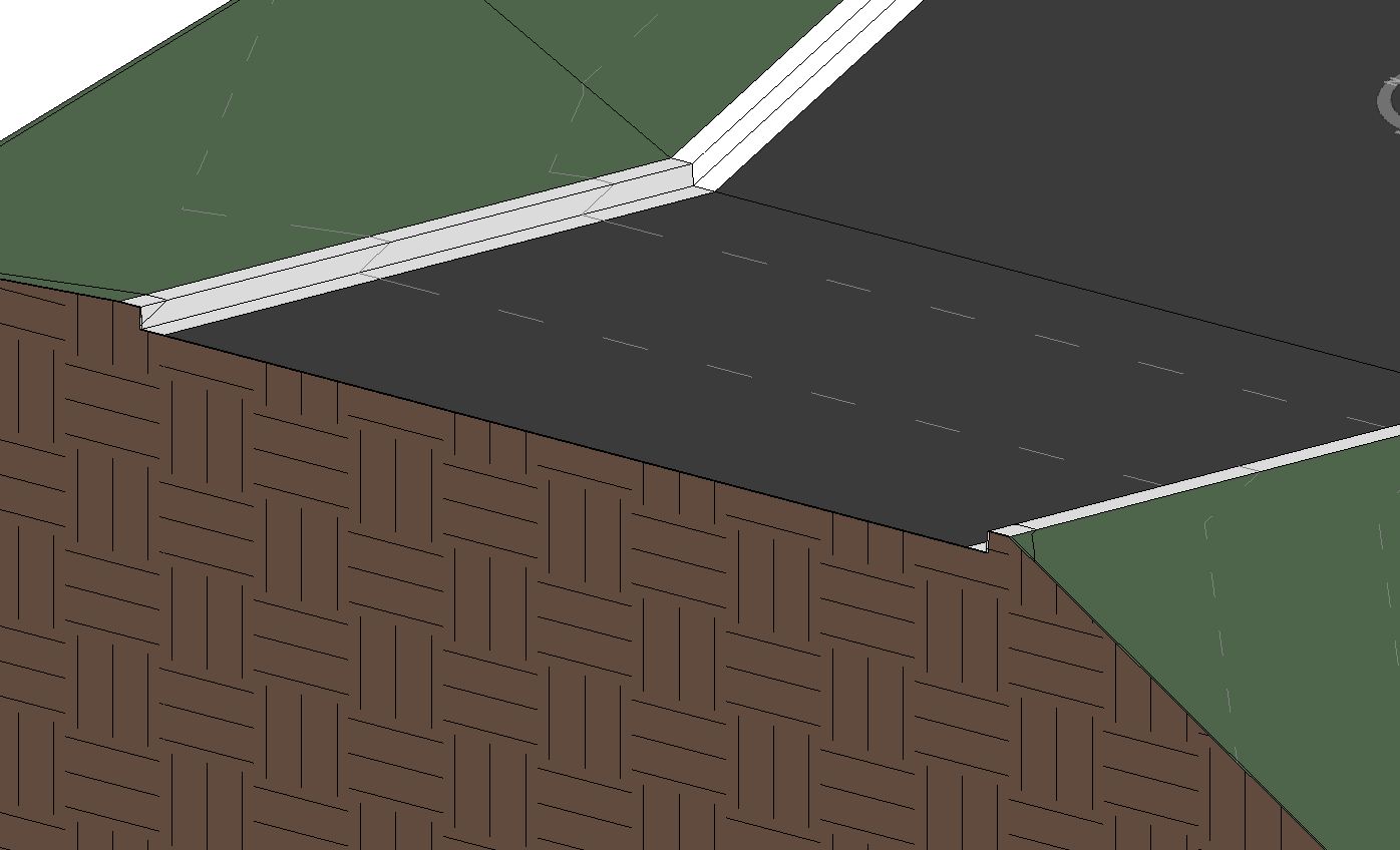

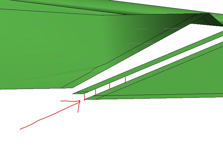

Hey guys need some help, cant work out what im doing wrong here, using Revit 2012
Wanting to create a road+Curb surface, have spilt my surface for the road and one for the curb.
Was attempting to merge the surfaces to create a straight sharpe edge between both ( result a curb next to the road), and what im getting after merging the surfaces is a steady incline. have unticked 'remove common edges'
what am i missing ?
this is what im trying to achieve
http://bimtionary.blogspot.com.au/2010/02/curb-and-gutter-along-topo.html
attached are photos to help my issue

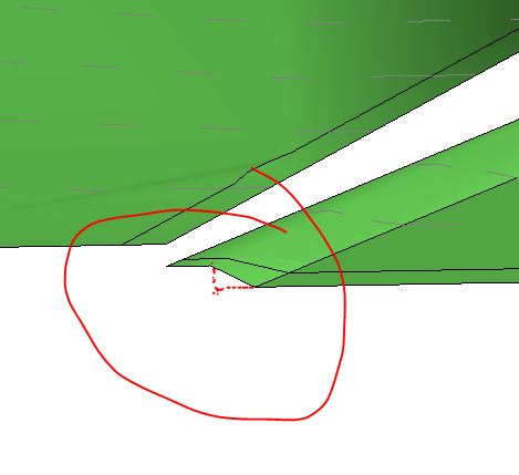

this is what im currently getting
Thu, Jul 24, 2014 at 7:08:02 AM | Toposurface Help (Merging Surfaces) Road and Curbs
This process works but you have to do all the steps.  You did not do this one:
Now, using the Split Surface tool again, Split each of the four 6" spaces 1/8" from the their shared edge - creating (2) 1/8" slivers of curb in between each of the two 6" pieces.
Those are the two surfaces that are merched to create the curb face.  Thus the face slopes the curb heigth in 1/8"

thanks for the reply, Thought i had done that, but due to working in millitmetres over hear realised my conversion from my head was wrong.
is there any other way to create roads or is this best practice ?
