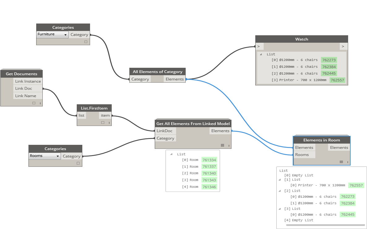

Archi-Lab has a Dynamo script that alows you to list elements from linked files by the room they are inside in the current file. Perhaps it is posible to make a script in Dynamo that can transfer the rooms, or list the elements in your file by rooms in a link.

Just tested, and it was quite simple to make a Dynamo script that can list your elements by linked room. Haven't been able to make a script that can copy the rooms from a link, but this is probably the best way, so you dont have to update rooms in your file.
