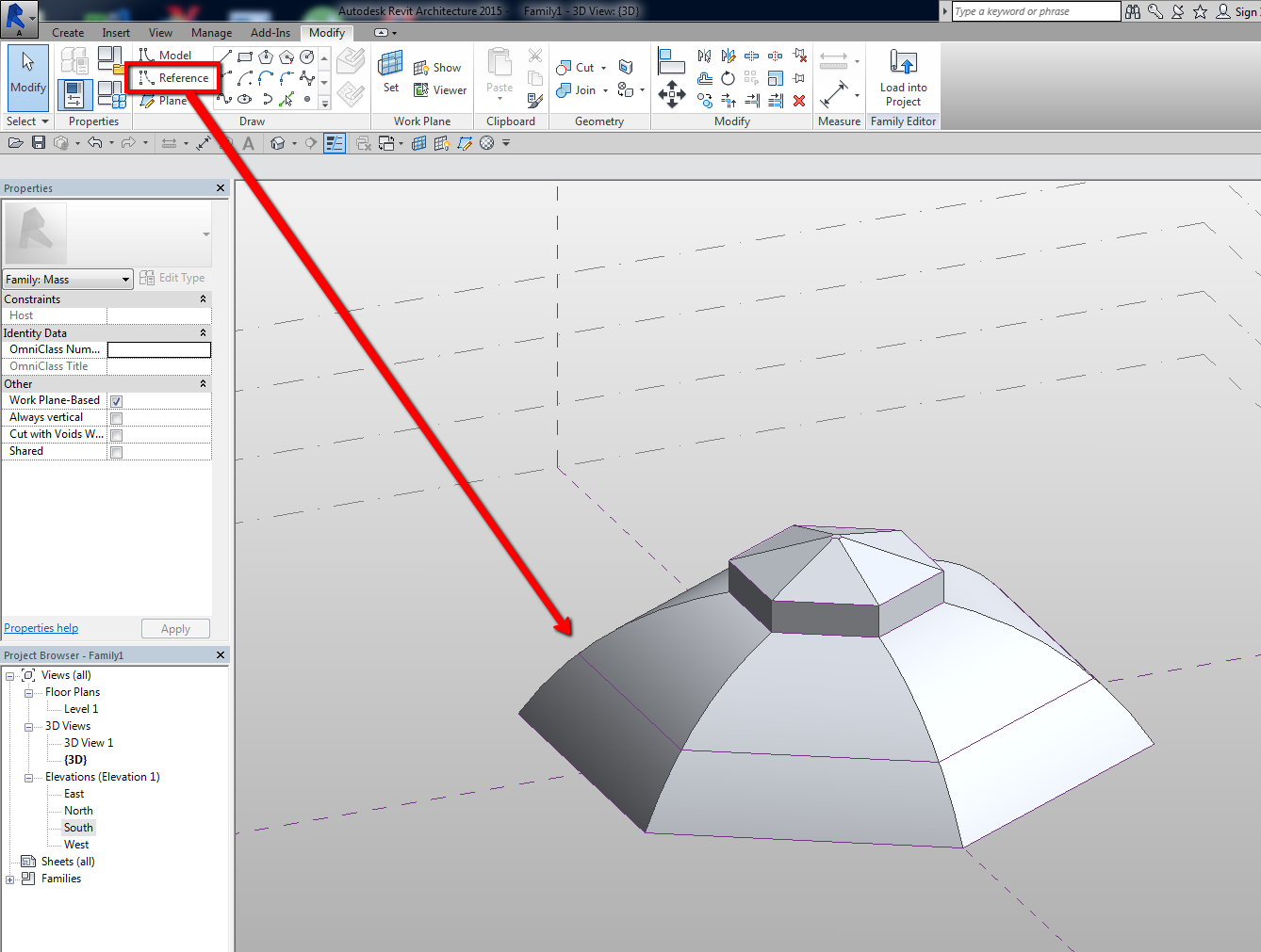

Can Anyone help me with how to draw the following two top pelements of this SketchUp Roof Cap as a Conceptual Mass in Revit... It seems simple but I am struggling with it... It could be a 6-piece element that is copied and rotated 60 degrees to create the forms... Any help would be greatly appreciated...

Use "Reference Lines"

Once I draw the reference planes do I connect the points with Model lines and Create Form...? When I try to arc between the first two refernce points I get a very skewed arc... How do I control the arc...? Thank you for your assitance...

I said "Reference Lines" not "Ref. planes" or "Model Lines",  create only 5 Hexagon ref. lines (look again my snapshot)
