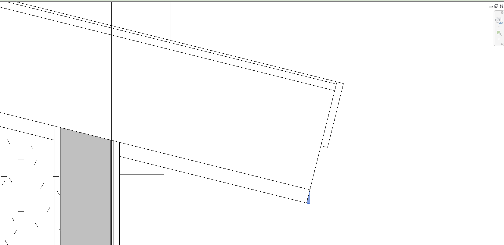

I would like to have the roof soffit that is at the same pitch as the roof to have an end cut same as the rafter/ roof. I am attaching a screen shot of what I am talking about

You could do this as an in-place sweep/extrusion or use a void to cut it how you want it.
