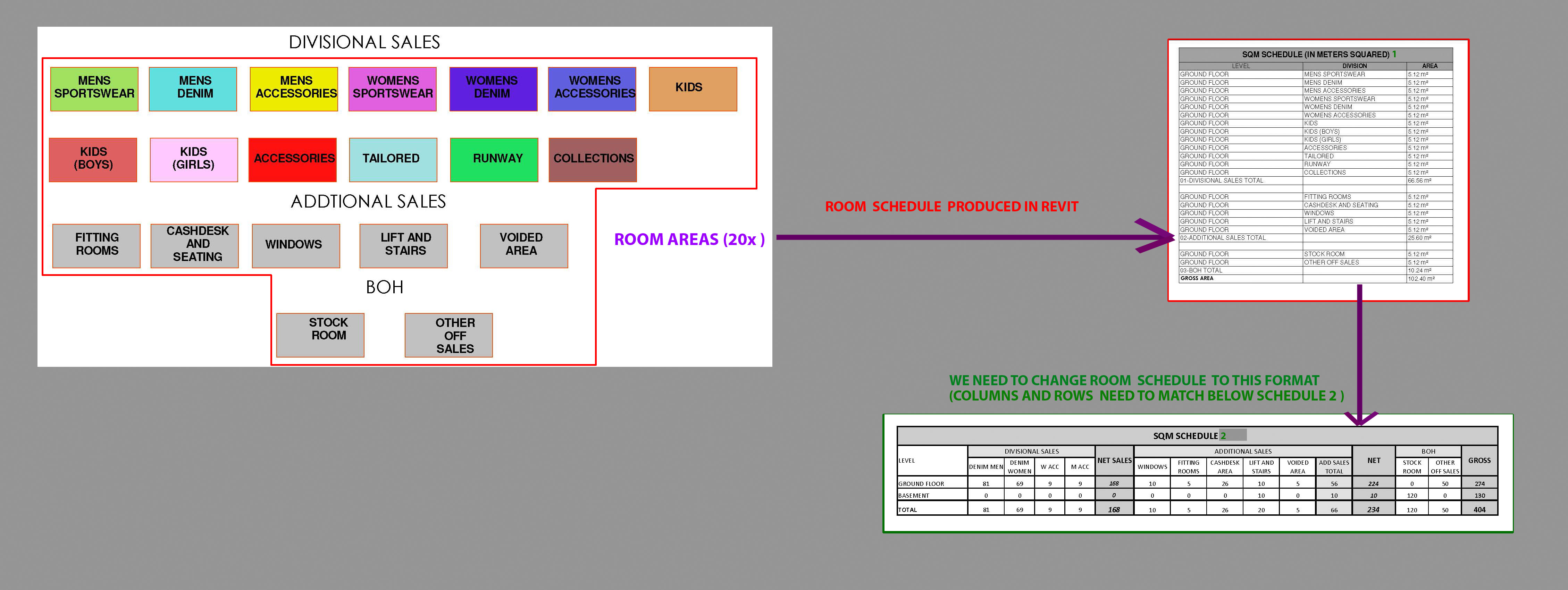

Our client ask us to provide room area schedule with distinct format (please see attached image-Schedule 2)
I have tried the best I can come with schedule1 as indicated on the image.
Does anyone have idea or way to achieve this?
Really appreciated if any one can help on this.
many thanks in advance.

Sorry - Revit schedules are not flexible enough to do what you want.  Elements are only in rows and parameters are only in columns.  Either get them to change or ...
  1. Create a dumb text and line schedule
  2. Export to excel
  • format as you want
  • print to a jpg
  • import the jpg into revit

Thank you so much wwhub for the very quick respond.I'm going to try what you suggested and hope to convince my client too.thanks again!
