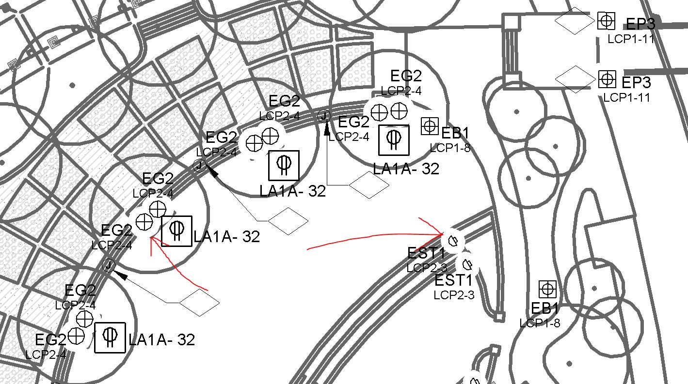

Does anyone know why some fixtures have a white border around them and some don't? I would like to get rid of this but am not even sure what it's called. This is in Revit 2014.
Thu, Jul 10, 2014 at 10:03:59 AM | White Border Masking Around Annotations
The family has a masking region in it.  Edit the family and remove that.

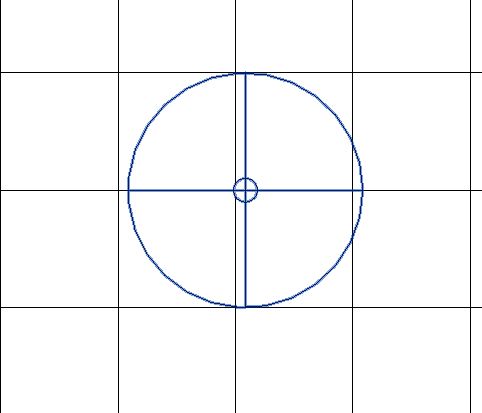

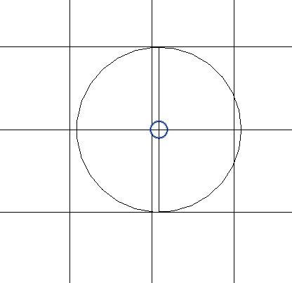

I attached one of the lighting fixture families. I couldn't find a masking region in it.
Thu, Jul 10, 2014 at 10:31:36 AM | White Border Masking Around Annotations
I don't see what you do when I place this hosted on a ceiling and it does not do this in the plan view either.
Thu, Jul 10, 2014 at 10:36:20 AM | White Border Masking Around Annotations
le is a detail item - shows up in VG under that category.  You can turn that off in VG ....
But your right - there does not seem to be a masking region in this nested detail element.

I just tried placing it in different plans and had the same result. It didn't mask anything. So it must have something to do with my background. It's ontop of a linked DWG file.
