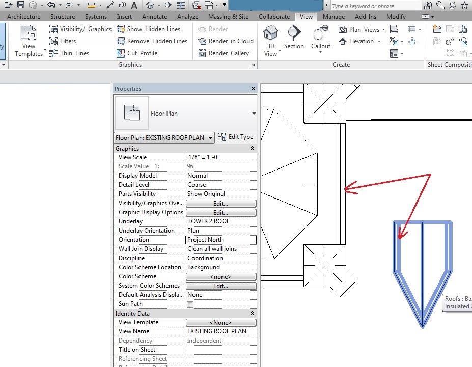

Ok i have this problem of the line weights not showing up on my roof plan and before anyone says try Thin Lines >TL i have already tryied that. On the model when i highlite a component its highlites (in lite blue) shows the wide line type but normally it is not showing. Am i missing any other setting?
Im running Revit 2014 BDS

So this is a line of a roof/component and not just a detail line correct?  I would assume it has to do with your visability graphics for how your roof projections lines are shown.

teafoe5, these are the lines of the rood/component and not detail lines. In my visability graohics, under the main roof i have set the projection/surface with an override with a #6 line wieght. But as in the attached image above when i hightlite an object it show the line wieght but un-highlited it is thin.

Update,
I got it working, my phase filter was set different. After i set the filter it showed up correctly. I guess thats what happens when you are going a million miles hour tring to get a project done. Thanks for those that looked at my post.
