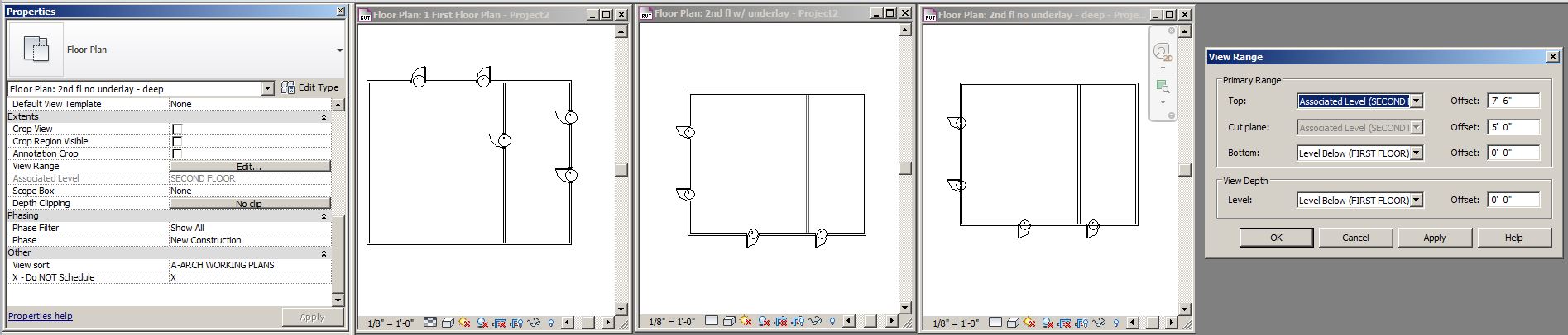

Your not telling us something because this just doesn't happen.  Look at the attached.  1st floor on the left has doors, 2nd floor plan w/underlay is in the middle <<< Note - no lower door swings, 2nd floor w/o underlay but view depth is on the right << note - no door swings.
So your settings are different then this and you did not tell us how.  Even a transparent setting will not show the lower floor door swings.
Either your door family is built incorrectly or your doors are being cut by the view cut plane or a plan region cut plane.
