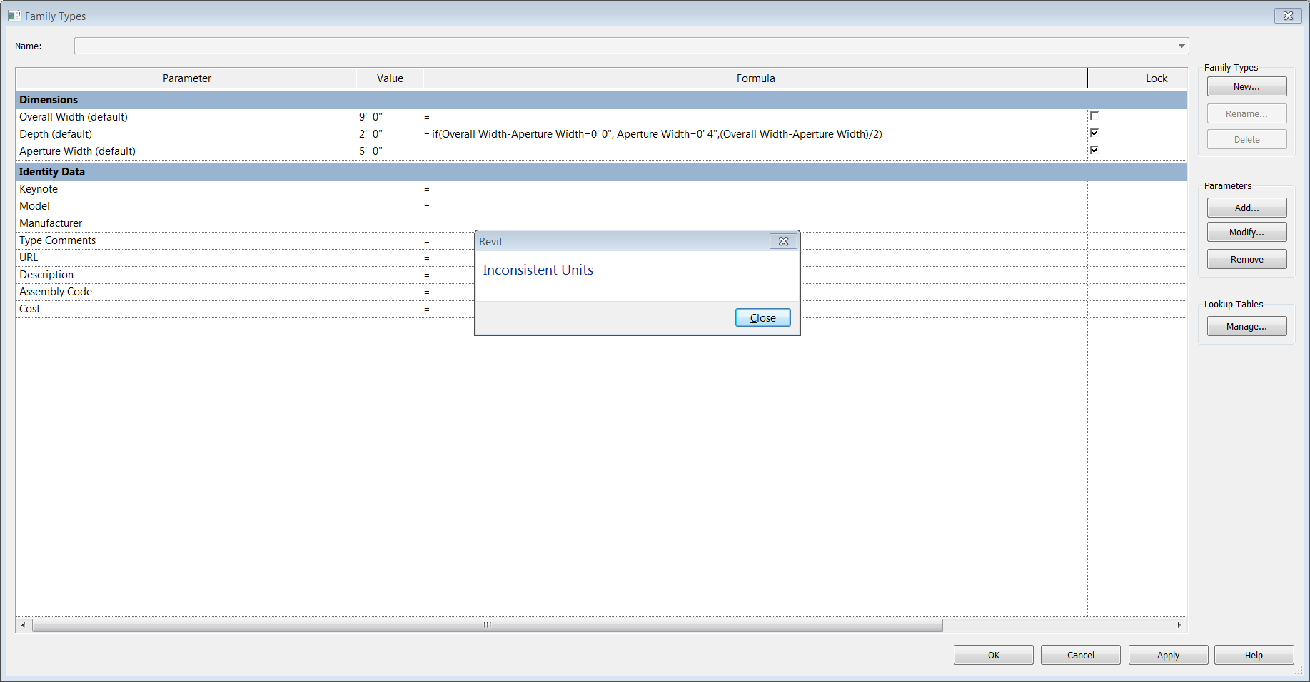

Why oh why Revit are there inconsistent units in this formula?!

Your second part of the formula is causing the problem.  That is the Aperture Width=0' 4".  You may need to change that into another if formula to get what you are wanting, but it will work if you put Aperture Width.

Gotcha. I broke it out into other parameters with conditional formulas and I seem to be getting it to work! Thanks for your reply!
