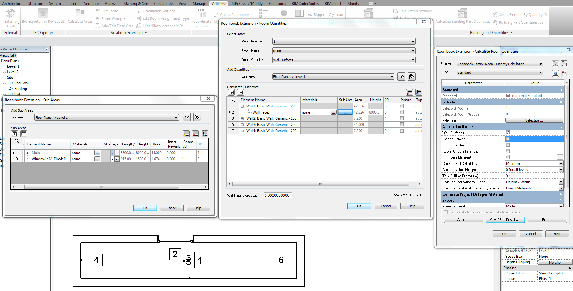

Hi I need help for Window to Wall Ratio schedule. I need to calculate WWR= (Net glazing area)/(Gross Wall area)
but I don't know how to insert schedule for glazing area and gross wall area together in one schedule.
Hope someone can help me to with calculating WWR using schedule
Thank You!
Tue, Jul 15, 2014 at 8:47:20 PM | Revit 2013: Window to Wall Ratio Schedule
ronmalit
Joined: Thu, Mar 29, 2012
113 Posts
5 Stars: 3 Votes
you can try ROOMBOOK extensions
from there you try to calculate your WWR
im using RVT2013, you can export to excel. but i think newer versions can save calculation to schedules.
(you must have subcription!)
