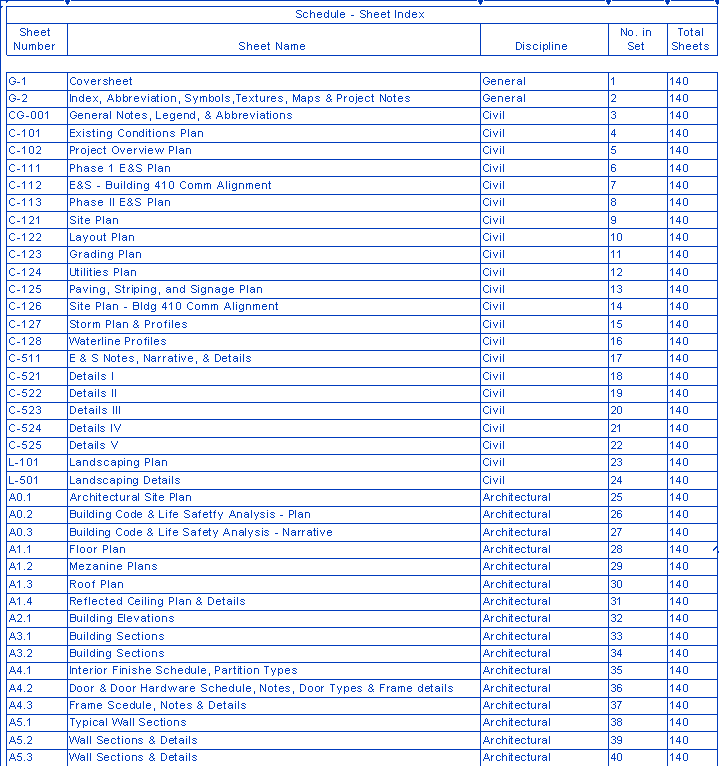

I have a typical sheet index schedule that looks like the attached image. Each sheet is assigned a "number in set" to indicate its exact location in the set's fixed, total number of sheets. This is becoming a standard request for the government projects that we have been working on. It is easy to coordinate MEP/structural sheets in this index and update the numbering when new sheets are inserted or moved around.
What I'm trying to do is have the title block automatically update according to the sheet idex such that each sheet can read "Sheet 30 of 140" However I can't seem to get the paramaters to work out. What is the easiest way to update the title block family to populate based on the sheet index schedule?
Mon, Jun 23, 2014 at 9:47:21 AM | Revit Sheet Schedule/Title Block Family Tie In
Revit has nothing that "reads" the sheet index.  Check out this google search:
