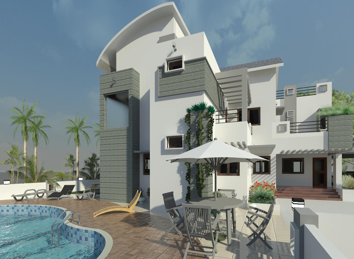

Okay, SO Im very new to the revit, and started learning it one and a half month ago. I know, this quuestion might have asked before and I even searched the forums but couldnt find the answer.
Whenever Im importing certain componenet, Architecture > Component > Load Family, they do not render in the colors they're supposed to, but GREY!
This is happening only with the few componenets, rest work fine. I checked the Type properties, no options there to change the material. I know sometimes the materials of the component can only be changed by going to the Manage > Materials, and then selected the specified material for that abject and changing it from there. But I even checked the materials, and there's none for that object name.
Im using Revit Architecture 2014.
Link to the downloaded component, its a patio table : http://www.revitcity.com/downloads.php?action=view&object_id=6207
I've also attached the screenshot of the render Smile
Please someone reply, its upsetting to not being able to finish my job at the last step because of this grey color after all this hard work Sad

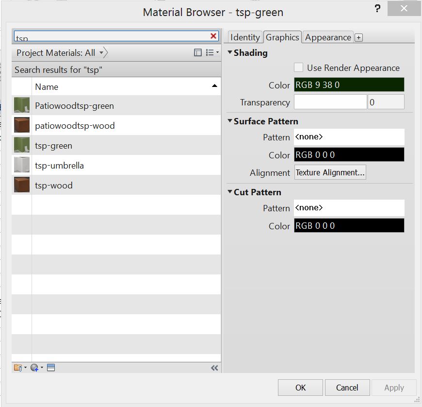

I did exactly as you said. I deleted the component from the project. Opened it as a family and from there renamed the materials (originally it was tspwood and so on, I renamed it to patiotabletspwood) then I loaded it into the project. Then I went to materials and checked if everything is okay. And both of the materials were there (refere to the attached image). But its STILL RENDERING GREY Sad
Please help!

Take a screen shot of your material browser in your PROJECT so we can see what you have under the appearance tab

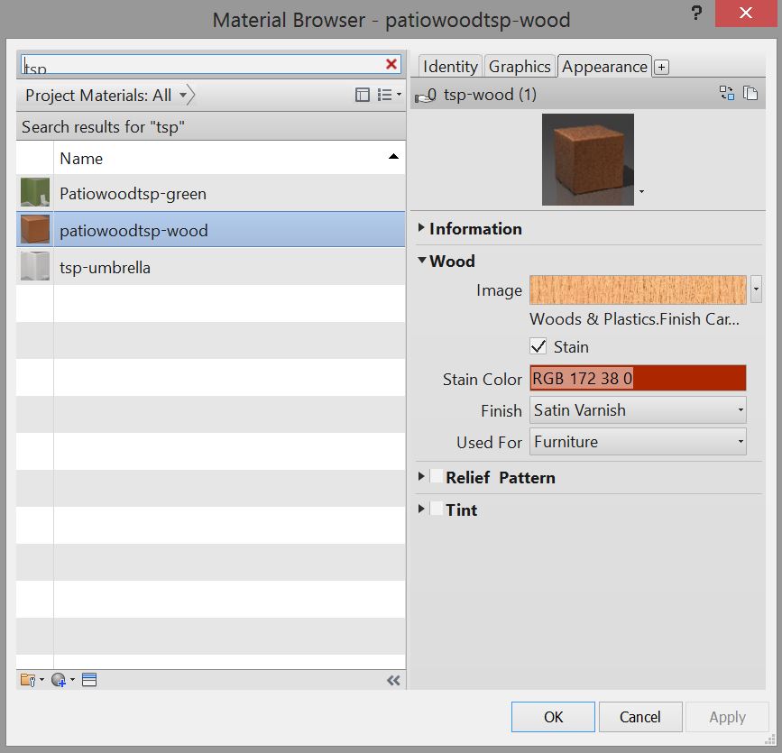

Mon, Jun 23, 2014 at 12:28:39 PM | Objects/Components render GREY?! :(
tojonegi
Joined: Sun, May 25, 2014
0 Posts
Okay, so how do I make those materials be USED or applied in the family?
I did what you said. Deleted the component form the project. Purged the unused. Deleted those materials from the project material library. Then loaded the compnent again. And now even the umbrella is NOT rendering white, which it was earlier :/ Now the WHOLE OBJECT IS GREY Sad
Attached the screenshot of the material appearance. .
HELP!

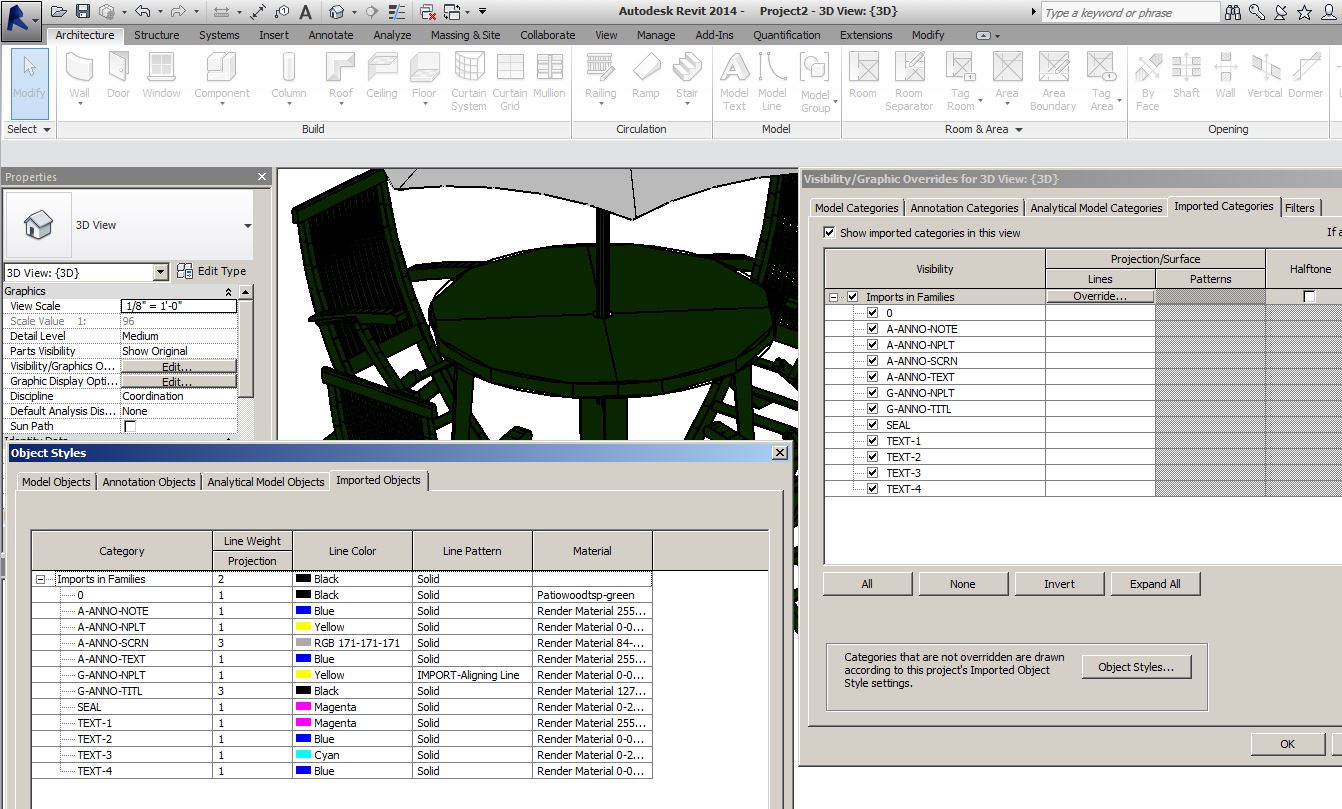

Mon, Jun 23, 2014 at 2:22:22 PM | Objects/Components render GREY?! :(
#11
Now we see the problem.  This is a CAD import into a Revit family.  Materials for CAD imports are controlled by CAD layer assignments.  EVERYTING in this CAD import is set to layer 0.  So every item will be the same color as assigned to layer 0.
I changed your layer 0 to green in the project.  The umbrella is a nested block and it will not respond.  I suggest you edit the CAD to place these items on seperate layers.
