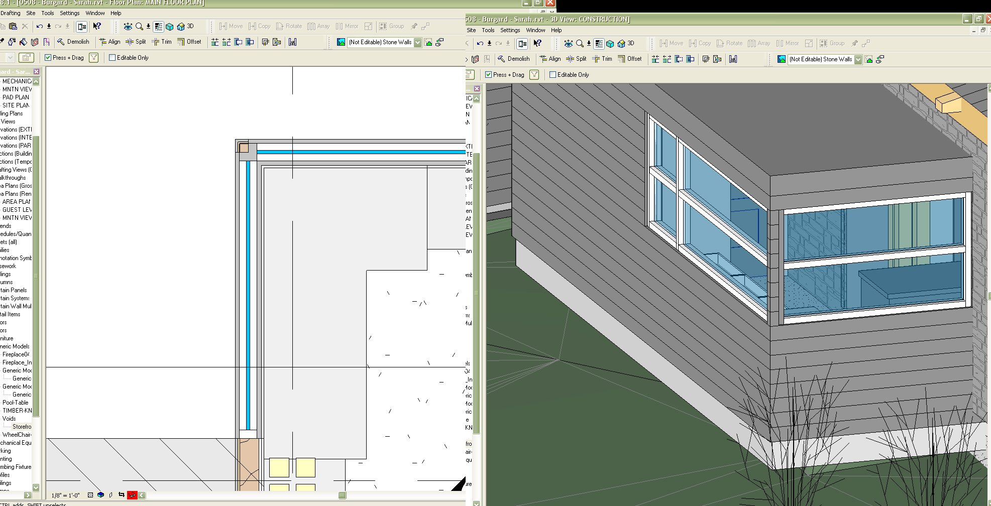

I've successfully added a series of storefront windows to my project, some of which are whole walls and some of which are openings in walls. I have placed quad corner mullions at each corner, but in places where the curtain wall does not extend to the ground I continue to see bits of my host wall wrapping the corner. How can I convince Revit to cut the wall and only show me the mullion?

Using window families I had to put a void in the corner. Using the opening tool just extend opening beyond corner and use curtain walls. Post edited on 2006-03-01 19:13:45

Here's a curtain wall and opening tool in use.
