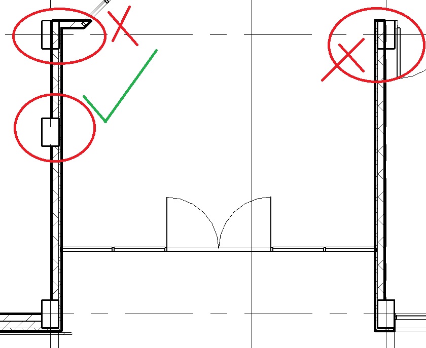

Same Family but wall pssing though into one column and another isn't.
please help me to find this problem.

Thanks for Instant reply, This colunm are in same family and Architectural column...and wall are also in samesystem family wall family , when attach colunm to top base then wall is showing itself  in some colunm.

Hi there, you might need to check if the wrong column's constrain, do they have the same constrain with other right columns? I doubt they did not sit on the floor level so that they were not cut by the cutting plane. That is to say, they were above the cutting plane.

Thanks Both of you WWhub and Junmo, All the column is in same constrain. I did "creat similer" and put on the wall and it was Ok. I think this problem is for not updating my Revit. Now I use Rev2015 and wall not shwoing into column after I attach to the Top base.
Thanks a lot
Edit: the problem seems again....attaching Top base the wall shows in columns...

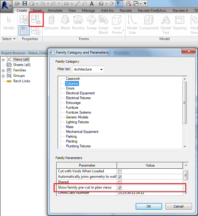

Have you checked the settings of "Show family pre-cut in plan views" in the rfa-file?
Edit family -> Family Category and Parameters -> Show family pre-cut in plan views

Yes it's is already checked. when column attached to top floor, the walls shows in to the column
