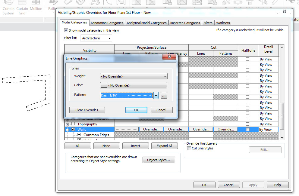

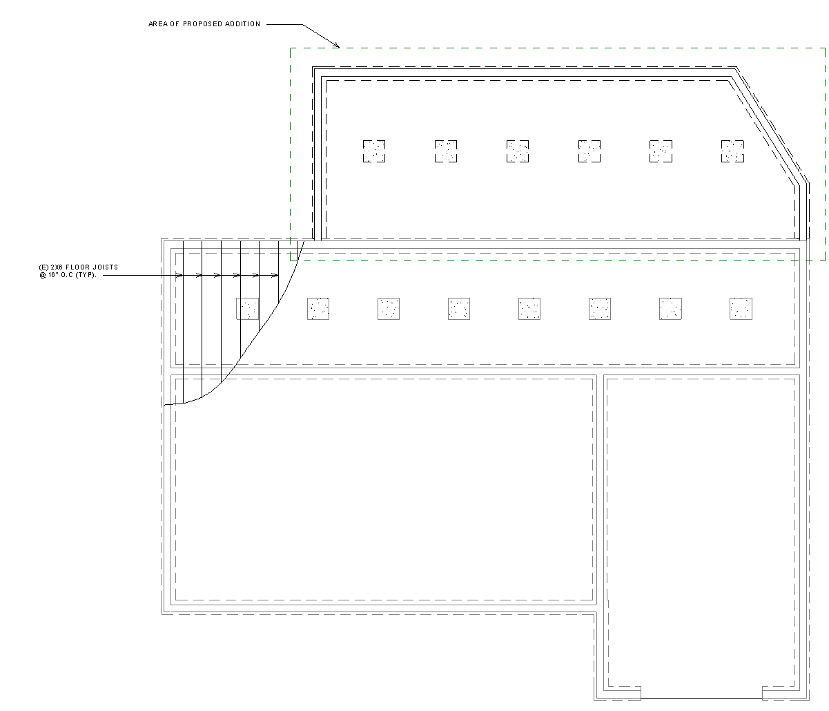

What is the easiest way to change the display of walls below the current view to show as hidden lines? I have a grade level at 0 elevation where I'll have 6" concrete stemwalls for a residential project. And I want to display the 12" x 12" footings below as hidden lines as they would normally be in a foundation plan. In other words, I want my foundation plan to illustrate as in the attachment. Thank You
Tue, Jun 17, 2014 at 11:02:31 AM | Changing display of walls below current level.
VG settings.

Thank You. I got it.
For anyone else searching- select the walls below, r-click and override graphics in view, change projection lines to hidden.

Thanks Blue442 but that's the way I originally wanted to do it but it changes ALL the walls in the view.
I don't want my 6" concrete stemwalls to be dashed. Only the footings below. See attachment.

I see.  You're nut cutting through the walls.  You're above them.  Yes, I believe the override would be the choice in this situation.

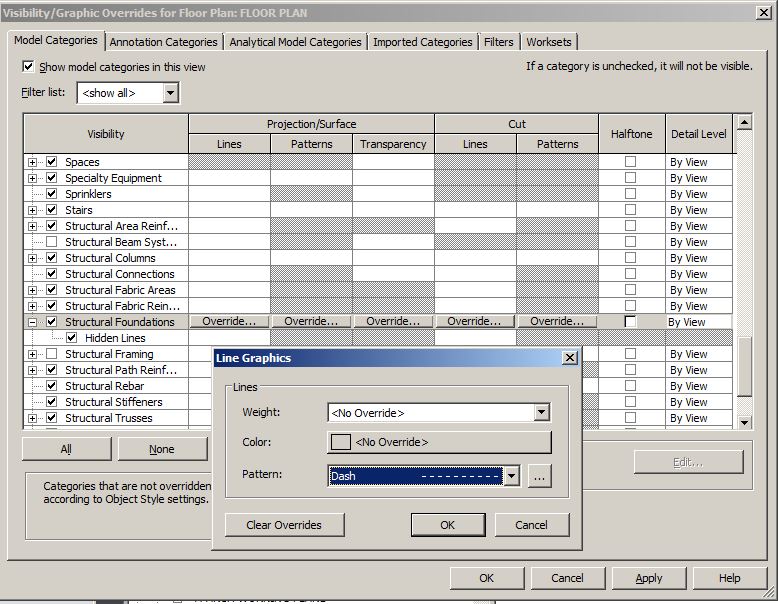

Tue, Jun 17, 2014 at 1:35:30 PM | Changing display of walls below current level.
You call them stem walls but they appear to be footings so that's why I recommended FG.  You appeared to have confused Blue442 because he indicated walls.  Footings are in a seperate category from walls so you should do it there for the reasons blue gave.  Much better off than individual over-rides.
Another method if you want selective foundation (stem) walls is to use a filter with that particular wall type.

Thanks WWHub. You're correct, (assuming that the footings, below the 6" stemwalls were drawn as structural foundation), but I made the mistake of
drawing them as 12" generic walls on the lower, (footing), level. Then I drrew the concrete stemwalls at grade level. So they are both walls the way
I have them drawn. Gonna fix that right now.
