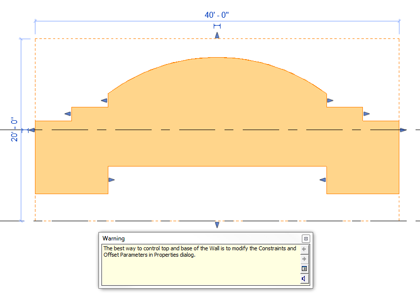

Hi All,I'm new to revit and i'm having difficult time understanding this warning when i edit the wall profile in elevation view. Can you help me understand and how to edit the wall without getting this warning?

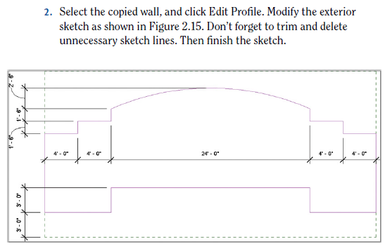

See attached photos or the warning, and the exercise i'm doing.
So here is what i did if you look at the exercise photo attached:
I created a wall offset at 6 feet from the bottom then created the other 4 feet walls on the left side, and mirrored the right side, after that i started trimming then when i finished the sketch i got the warning message.
Thank you.

The warning comes because instead of offsetting your base and top constraints to where you want them to start you left them on the level and just edited the profile and moved it to where you wanted it.
