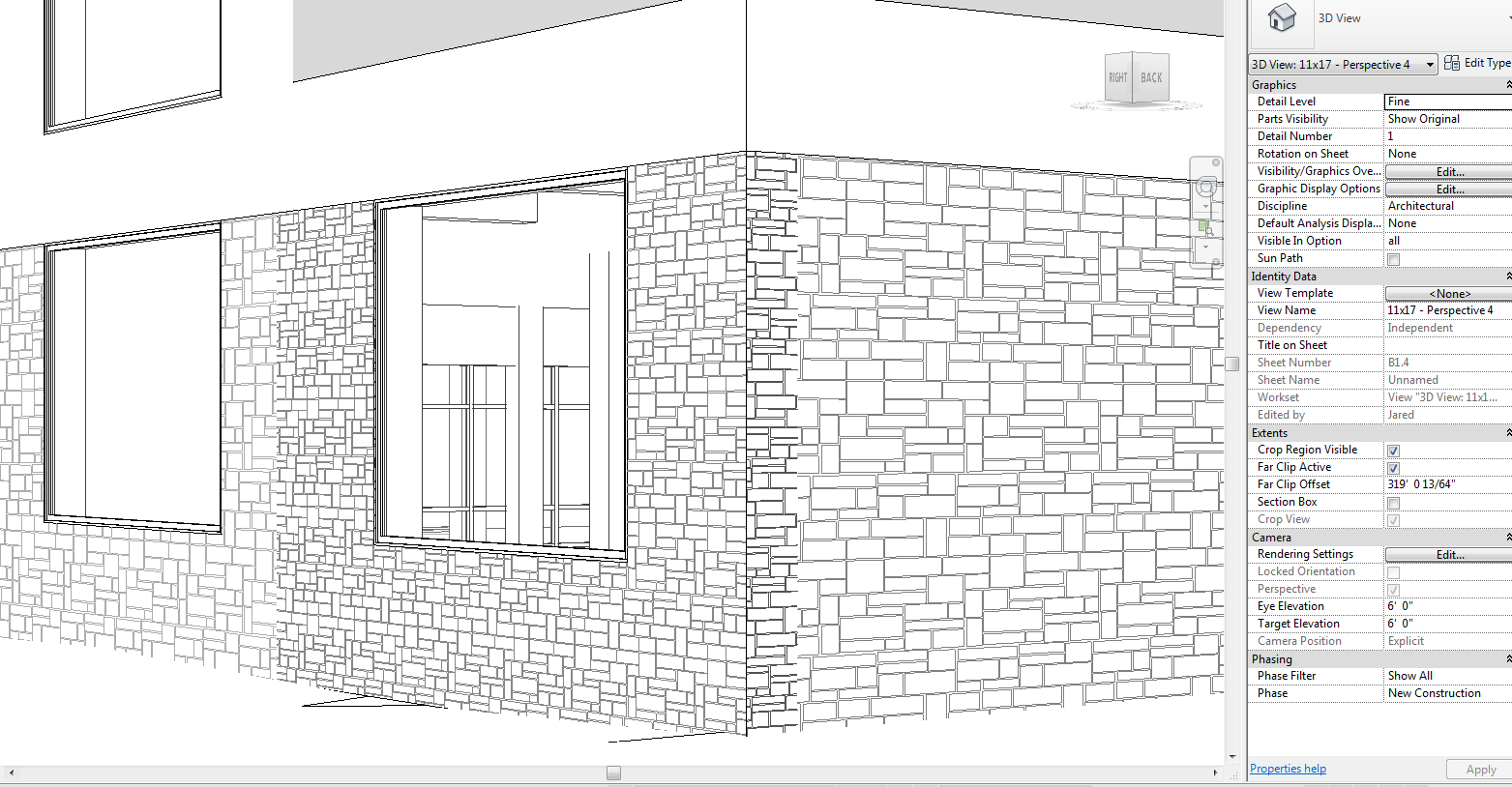

Hey guys, I have a model with a custom random ashlar drafting material. I have added it to one of my exterior walls, and on one of the 3D views we have been showing to the client, it is showing up at differing lineweights and scales. It is the exact same material, same phase, same workset, etc. Any idea why this is and how to fix it? Pictures attached. (Note: the wall is split on the left where the heights of the wall above change)

I would say try "match properties". If that doesn't work, I would erase and extend the wall to the left (in the picture), and then re-split. It might just be a hiccup (not enough info without seeing settings).
