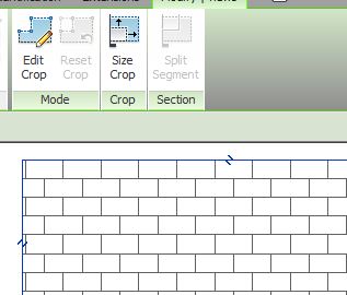

Click on the view crop boundry and you will see the following:

I meant the crop region/depth clipping in plan view, but what you pointed out is something I hadn't noticed before- still good knowledge!

You have to have clipping turned on for the view to see the sides and far clipping set to see the depth.  But no shape controls....just a rectangle.
