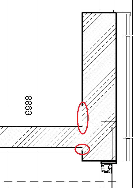

Hello, i ve got this trouble... tryied to JOIN the floor and the Family Bean i imported into the revit... the concrete was connected but... in 2 cases where different materials touch my imported family... the thick line of the concrete stops...
Why is that?
 could anyone have any ideea?
Thanks
Tue, May 27, 2014 at 7:58:43 AM | Materials
You will have to use your linework tool there.
