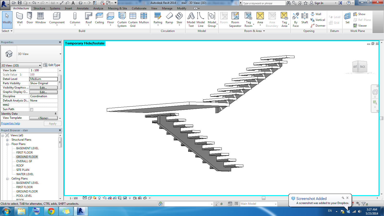

using revit 2014, i was doing a stair with only a middle stringer but i couldnt find an option to complete the stringer on the landing!! is there any ??? (( SEE THE ATTACHMENT ))
i know that i can model in place the landing .. but i dont like this method in case i want to modify the stair later.
thanks
Fri, May 23, 2014 at 8:55:52 AM | middle stringer on landing
The middle stringer has always ended at the landing because the landing usually is defined differently.
There is an on-line library site that has stairs back to 2008 or 2009 (maybe earlier) and those stairs worked the same.
