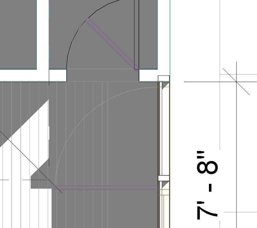

Is it possible to NOT have two walls join? I have a curtain wall to framed wall connection and RVT connects in the way shown below. I want the last frame on the curtain wall to stay proud of the stud wall. How do I do that?
Thu, May 22, 2014 at 11:37:09 AM | Wall Join - How to Turn Off this option
Gee ... you search help with... of course, wall joins ... and what do you find?
http://help.autodesk.com/view/RVT/2015/ENU/?guid=GUID-10DB1268-CA74-4620-8A1B-AF412BCD36D6
Disallow Wall Joins
Pretty obvious.
