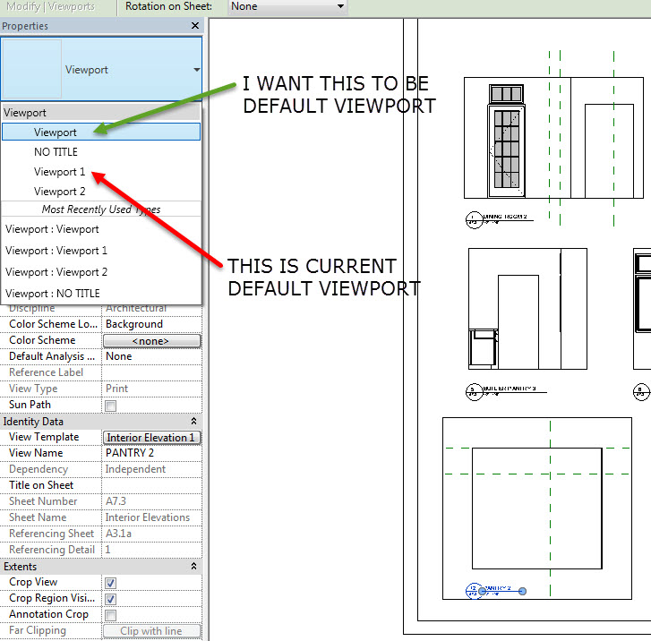

Seems simple enough, yet has not turned out to be that way. Everytime I drag a view onto a sheet I get the viewport type I don't want by default. Therefore I have to change that for every single view on my sheets. There has to be a better way to do this. Pic attached.

There is no way to have it "default" to what you want.  You would need to purge out all the other views and change the Viewport 1 to what your Viewport looks like.  Thats the only workaround I know of.
Tue, May 20, 2014 at 3:55:57 PM | Default viewport type R14
I think that is what we did years ago.   Changed the default then added others.

kind of ridiculous, but thanks for getting back to me guys
