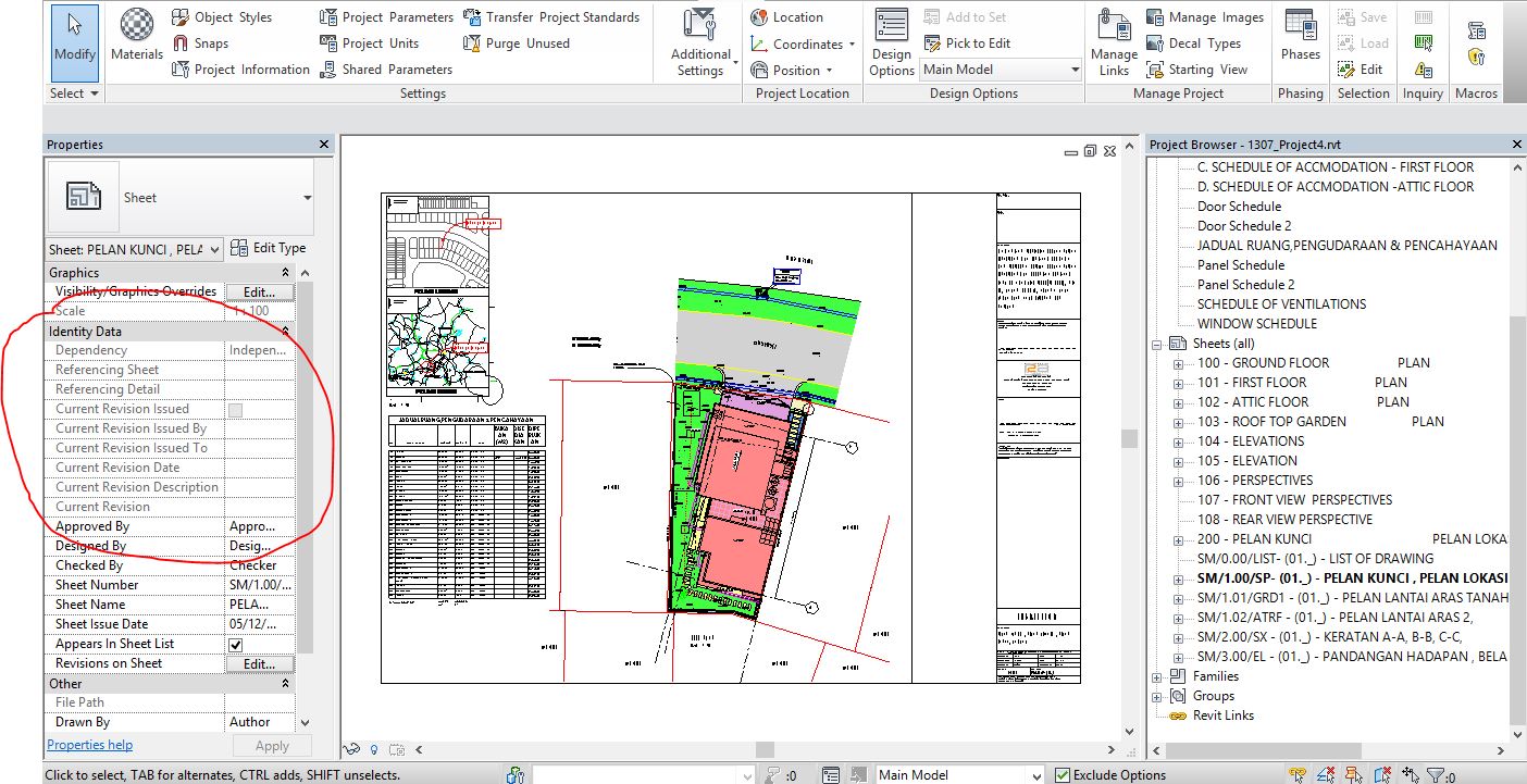

Wondering  how to work with drawing revision. In my attached image from my current working project files, it's found
out the area in the identity data area has been greyed and inactivated. Curious on how to make it editable and could all
expert out there briefly explain this issue.

You don't fill this data in, it comes from placing revisions on the sheet.  Please read your HELP on revisions.
