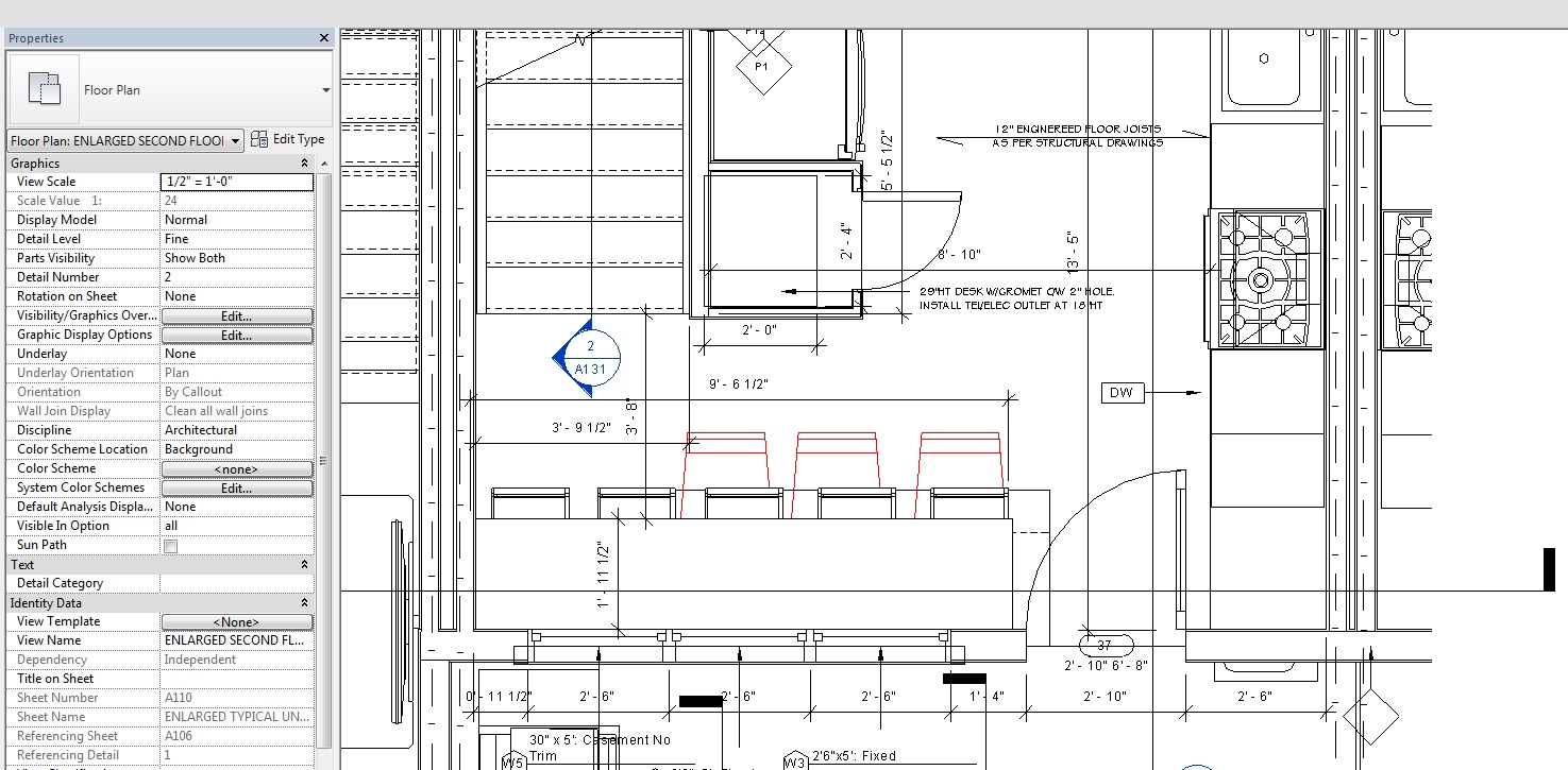

Good morning
I have checked visibility graphics, manage links, autoCAD links, highlighted all and tried to filter, imported categories rewview and no matter what I try I cannot remove the red lined autoCAD line work on the level.
It will not let me highlight it. I have looked at the slevt pinned elements which it is not...completely stumped on how to remove these lines. Anyone have a suggestion. I thought they might be an autoCAD import
Cheerssee attached screen shot
Wed, May 14, 2014 at 1:16:55 PM | Revit 2014 Imported Linework
Under VG, turn off layers of the CAD file a group at a time and identify what layer they are on.
