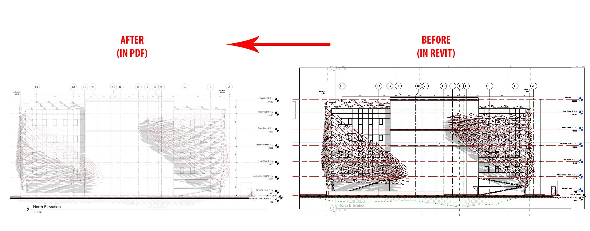

Using revit 2014,
when i plot from revit to pdf, the images with shaded visual style become gray (SEE ATTACHMENT) . Does anyone have a solution for this issue ?

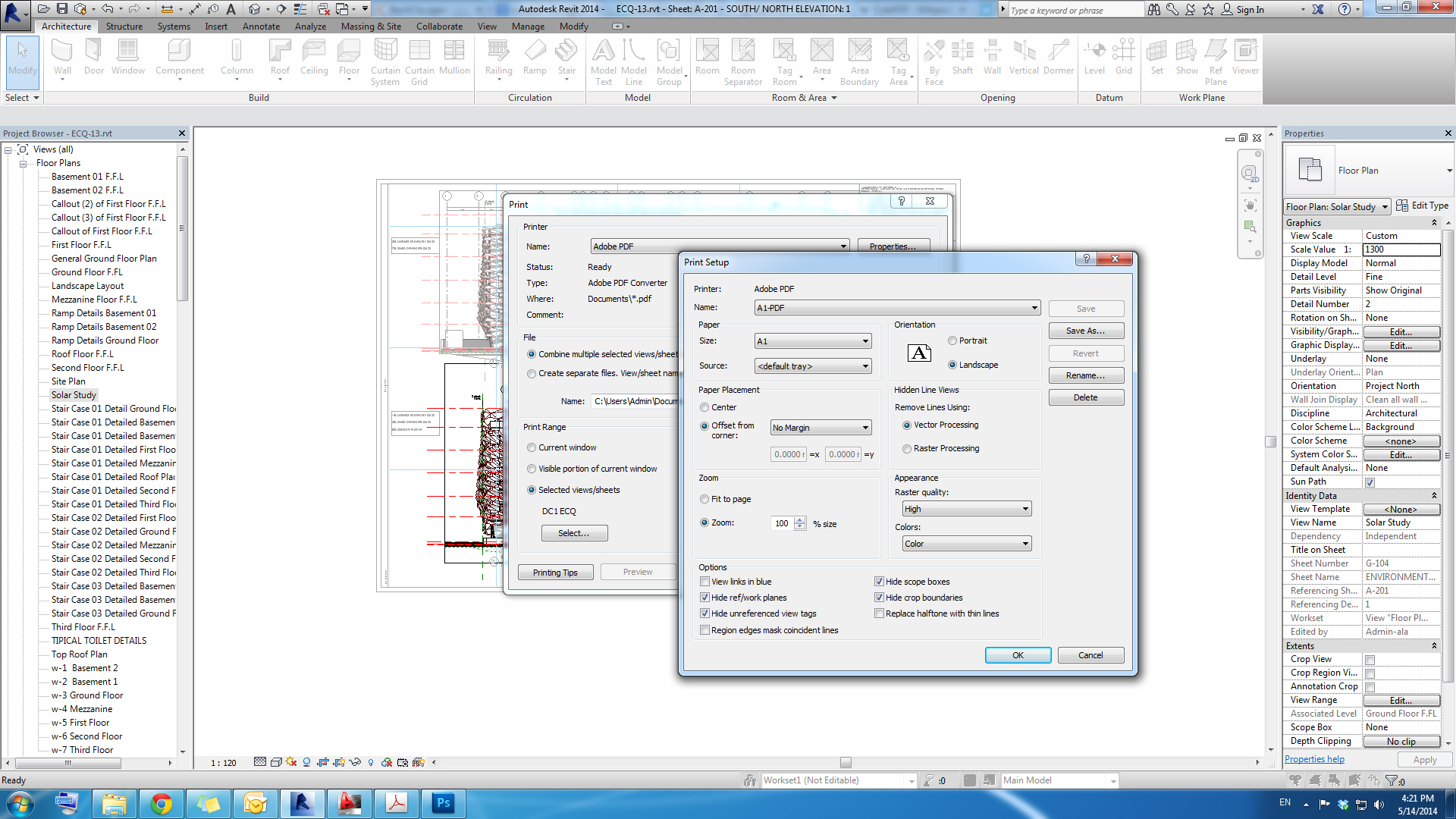

So what are your plot settings:  Please post an image.

Here you are

You printed the view while it was activated on the sheet.  That will always ghost the view.
I should have seen that earlier.

here we are.. i tried to deactivate the view and plot again .. but still no luck
