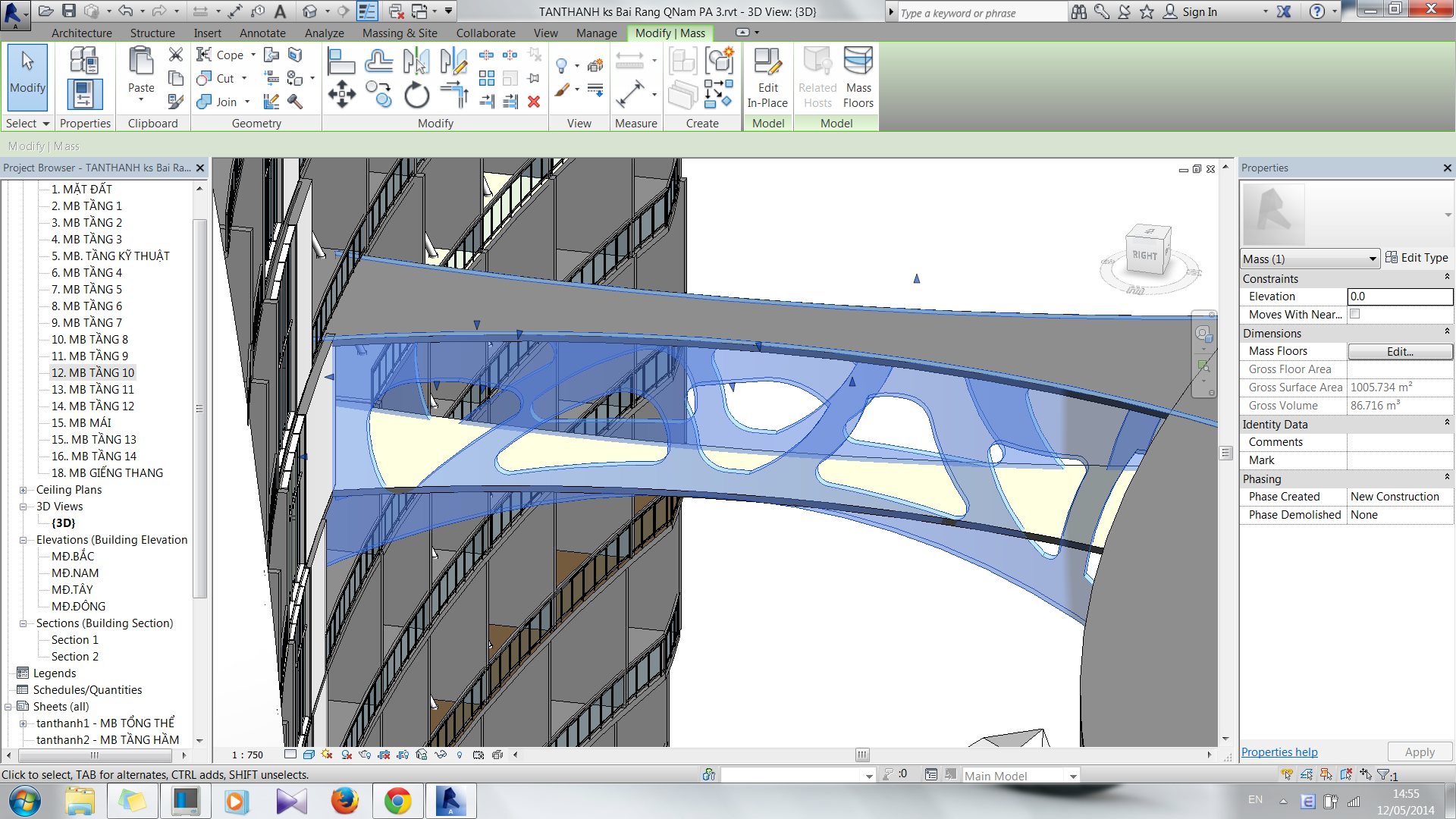

I want to create a curved wall (i'd like to void some hole in this wall). I create a mass and void it. But now i don't know how to create a wall from this mass. When i create a wall, all void forms lost. Can anyone help me. Thank you.

Wall By Face

It's curved wall. When i use wall by face, all hole which i have void will lost.

What about subtracting the voids after the wall is formed by face?
