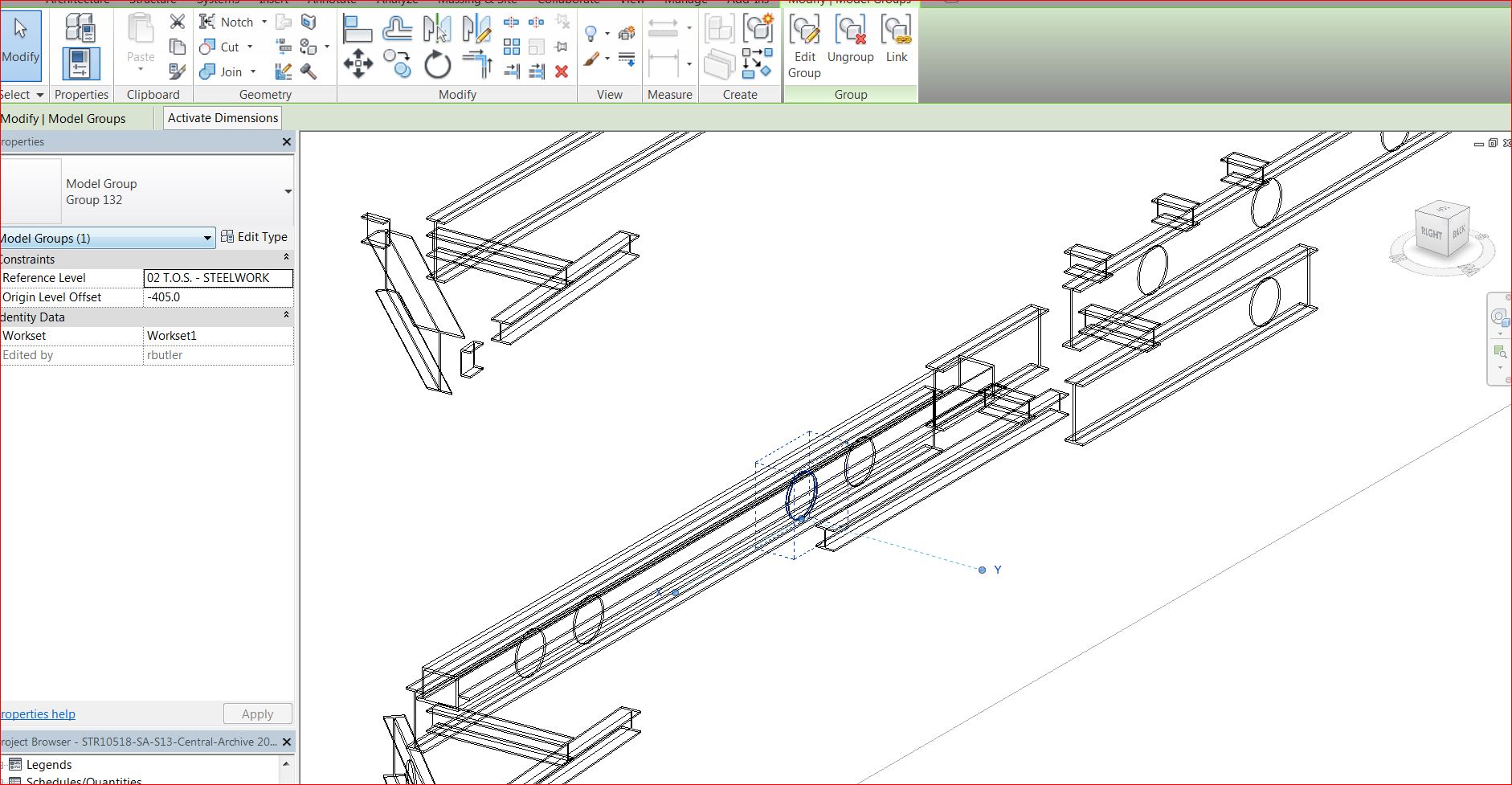

desparate for any help, i need to sweep the model by floor to put elements in a new phase, but when a service hole is included in the selection i cannot modify the phase, i need to remove them from the view. i cannot hide by category (greyed out)  what am i not doing right?

You can't change the phase because it is in a group.
