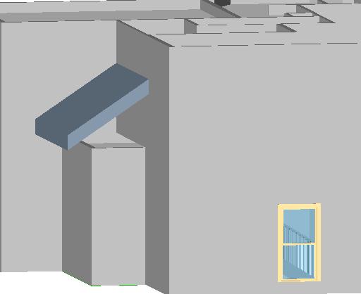

I am in the process of designing a house. I can not get the walls to jion the roof. Here is what I mean. Can someone help me

pretty easy really - click on the wall and a series of choices appear. choose attach top and choose the roof.

Thanks. That was pretty easy. I new at this.
