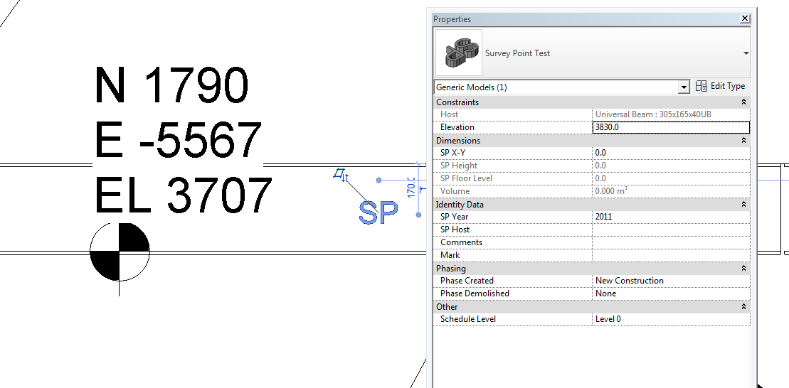

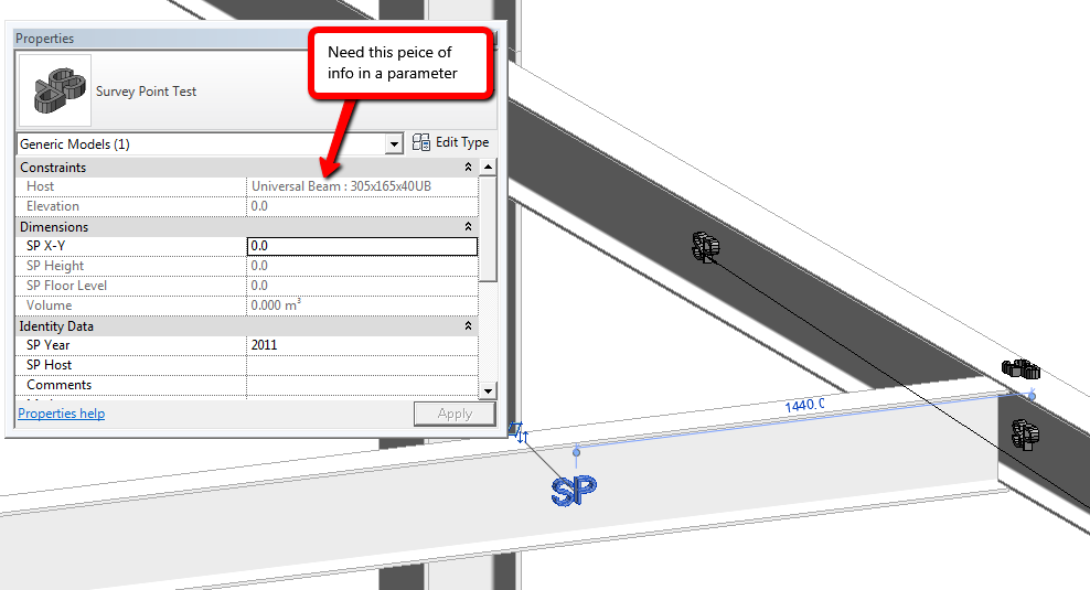

Okay I have not found how to read the Host system parameter so I can schedule it.  Has this been done before?  Can it be done?
Reason is that I could have somewhere up to 1800 instances in the model and I want as much automation as possible.
