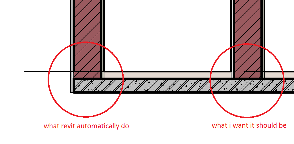

hi,
i am geting a problem when joining between wall and floor in revit and i don't know how to make it right. the problem is when i join wall and floor which have same placed edge, it automatically turn same placed edge into thin line while it should be wide line (see attched image below)
currently, i have to draw manually a wide line right to this place.
thanks for reading and any help will be appreciate!
p/s:
this issue occurs at same placed edge only (draw floor by pick wall - extend to wall core)
sorry for my bad english Sad

Thu, Apr 24, 2014 at 10:16:29 AM | join between wall and floor issue
Post an image for the "Edit Assembly" of both of those walls.
I believe your problem is layer priority.  You can read about that in your Help:
About Applying a Function to a Layer of a Compound Structure
