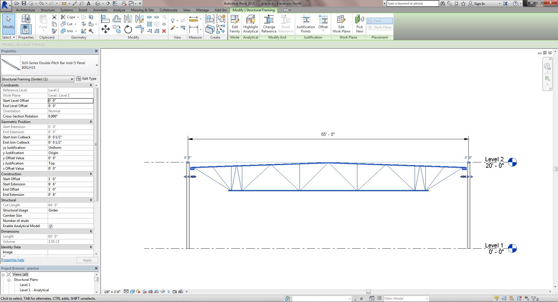

I have a project coming up that is going to require double pitched underslung joists. I have done a fair amount of looking on the web and around forums for easy ways to either modify the joists already in Revit for a double slope or I tried to find someone who has already done something like this. It sounds like there are a few who have done something like this but I have been unable to figure it out. I have a basic understanding of revit but have not worked with creating or modifying families.
I am using Revit 2015. I see in thier family library that they have double slung SLH joists already in the library but when I place them in the project, the peak is lined up with the floor level I placed it at. I included a screen shot showing what I am talking about in Revit. I understand that I can change the base offsets to make it line up, I would just like to know if anyone knows a way to not fake it in.

Click on the joist and attach an image of your properties, I have a feeling you have it associated with the first floor and an offset on it.

Thanks for the advice. I wll check out the guide. I attached the screenshot of the joist in a practice file I am working on.
