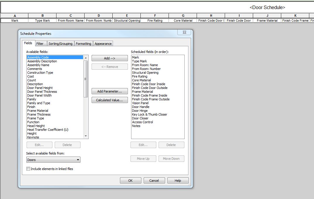

Hi all,
I am currently setting up a template in which I would like to schedule the material mark of the frame finish, door finish ect.
However, I can't find a way to do this. Is it possible or should I just settle with the material?
The closest I have come is to do something with hidden fields in the schedule, but I can't wrap my head around this would be achived.
I have attached a screen grab of my finishes schedule and door schedule.

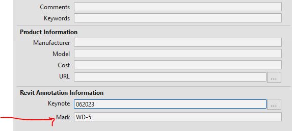

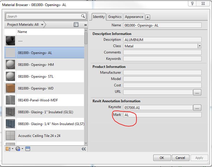

I don't have an answer, but basically have the same question, so I'll bump this and add a bit more as it relates to what I would like to do:
Is there a way to use the "Mark" field listed under "Revit Annotation Information" on the Identity Tab of the Material Browser?  See the attached image.
If this is not possible, the alternates I see are: 1) Adding a text based shared parameter to my door families that has no relationship to the material assigned or 2) Naming the materials according to the abbreviation I want to see in my schedule ... I do not like either of these options.

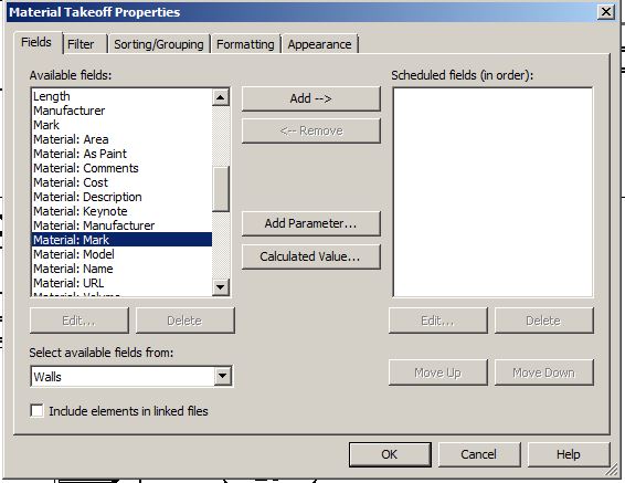

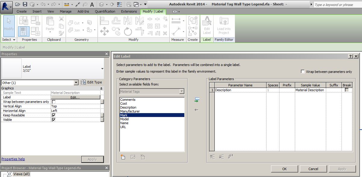

Tue, Jun 17, 2014 at 12:29:30 PM | Schedule material mark in door schedule - Revit 2014
Materials are tagable using a Material Tag.
See attached.

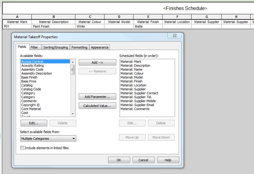

Tue, Jun 17, 2014 at 12:34:30 PM | Schedule material mark in door schedule - Revit 2014
Materials can also be scheduled and the Material Mark is available there - see attached.
Splitting the door material MARK from the frame material MARK could be more problematic but their is a Material mark available under the door schedule.
