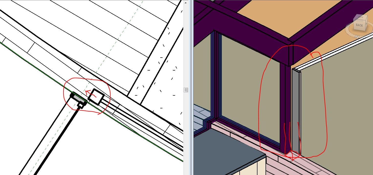

I want to make the "curtain wall corner mullion" occupy the corner like the sketch indicates. but the wall jumpes out of the way, and wall intersections tool doesnt work here. how to get the mullion onto the corner, without the walls joining.
THanks in advance.
Edit: figured it out kind of. pulling the framed wall away, let me move the curtain wall end to the right spot, then putting the framed wall end back didn't cause the join condition to jump to another configuration. fussing with the wall joins manually worked.

I know you may have figured this but for future reference you can disallow the joins by right clicking on the dot at the ends of walls. By disallowing the join it will not automatically try and join the walls. It's generally very handy for curtain walls as they have a tendency to jump to where you don't want them - this can affect scheduling too if the blue dot is in a wall it will schedule longer even if the end mullion and panels stop short of the wall.

Thanks!!! that was what I was looking for. couldnt find the disallow. thanks.
