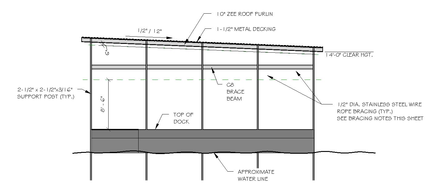

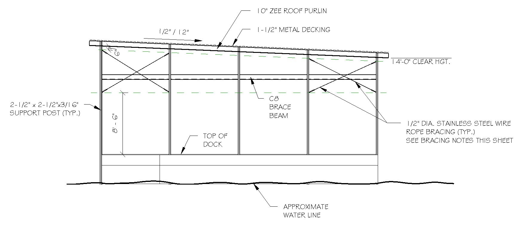

One more question if you happen to may have an answer.  I downloaded a wire rope from here on revit city to use to brace to columns at the HSS's.  They work great and look great in the section when I cut it but when I switch back over to my "overall" file (where I have my sectioned linked in with your help) the cables aren't showing up for some reason. They are modeled as a generic model family.  I've attached a snap shot to give you an example.

Try if maintaining same 'Detail Level' and/or 'Visual Style' works.
I am not 100% sure. But just give a try!

Just realized I never closed this session.  Come to find out I didn't have my section mark in the right place.  I still had it on a bay that was unbraced.  It was 100% my fault user error.
