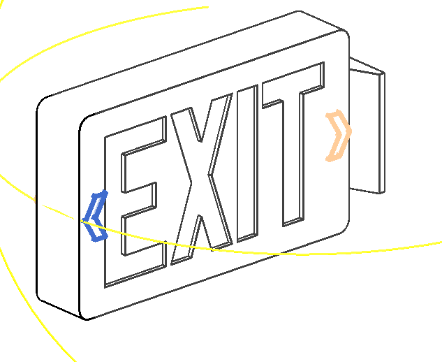

Your verbage is not a solid, it is a void.  Edit your families and one at a time, pick the cut tool, then the tan items then the main sign.

  1. Edit your family
  2. one at a time, pick the cut tool (from the modify tab)
  3. then the tan items (in the lower left corner it will say second pick: select the solid object to be cut by the void)
  4. then the main sign
I thought it was prettey clear the first time but you have to be trying to do it....
I suggest you do this from a 3D view.
Image - "Exit" has been cut - void arrow blue has been selected - tan arrow waiting........

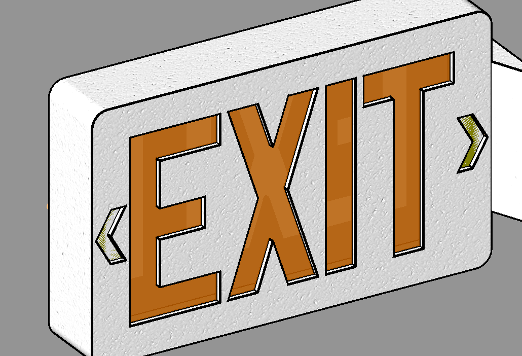

One more question. Do you know why when I switch it to realistic why the red doesn't show up on the text?

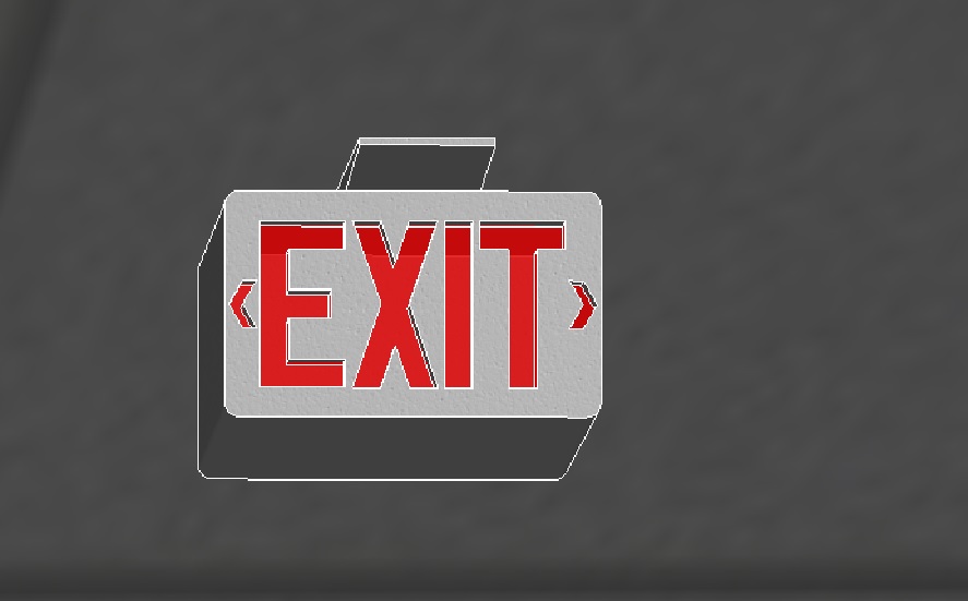

Got it to show red but it looks like this. Cannot get the red to come through clear and to look more realstic.
Mon, Apr 14, 2014 at 7:22:28 AM | Parametric Exit Sign
That looks like you have two surfaces in the same place - one red and the other?

I have a parameter set up with a yes/no button to be able to switch from red to green letters.  I was trying to create a sign that was universal that ultimately everyone could use.  Hopefully you can help me accomplish this.  Looks like this is the last issue for the time being.

Make sure your void is cutting deeper than your letters.  It looks like they are on the same plane right now.

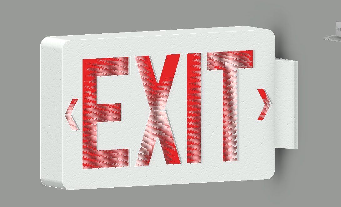

You don't say how you got the color back into the cuts.  Paint those surfaces in the family with a material called "xxx" and let the user set the color in the project material settings.
I used your RED

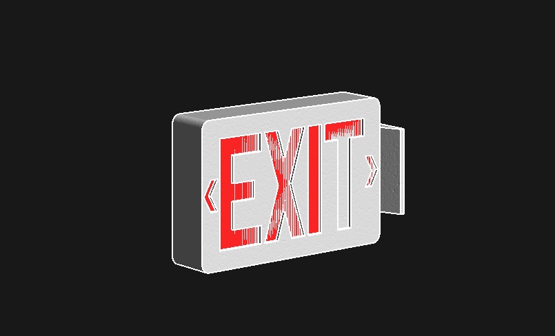

I have a parameter set up where you can change the letters from red to green.  If you look inside the case I'm using a void to control the coloring which is linked to the parameter.  I have compared both of the familes below and cannot find a difference among the two; however, the ceiling mounted sign works great in all ways including the coloring but the wall mounted letters will not work.  Ive upload the rendering views and the revit file of them both.  I'm pretty much giving up at this point.  All the parameters controling the arrows, 1 sided, or 2 sided works with the sign and annontation so thats what matters the most.  If you can fix it and upload that would be great but I'm going to have to move on as this is slowing down production.  Thanks for all your help.
