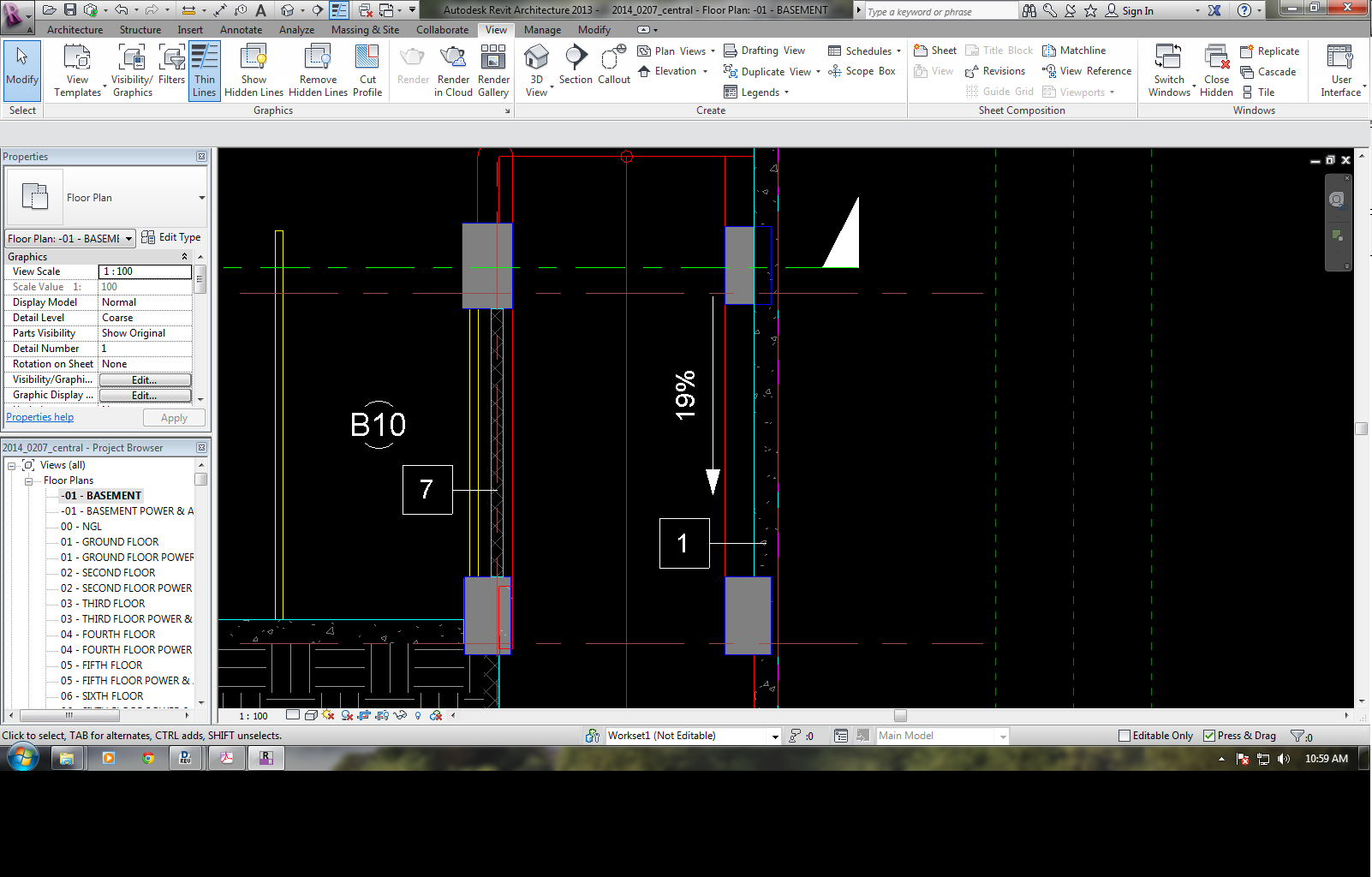

Hi guys,
my revit architecture 2013 seems very unstable.  at one time, my plans looked ok just as how i want them to be.  but at later times, there are  elements that unexpectedly move or change. just as illustrated on my attached image.  here, im showing 4 structural columns. the column at the lower right looks ok and that's how the other 3 should be. Before, they looked all fine. but now, these changes appeared.  i don't know what i am missing here. please help.
thanks.

Pretty busy area. Locks like alot of of overlapping elements (CAD files too ?) and view range issues as well. Also looks like some sloping stuff in there too.
