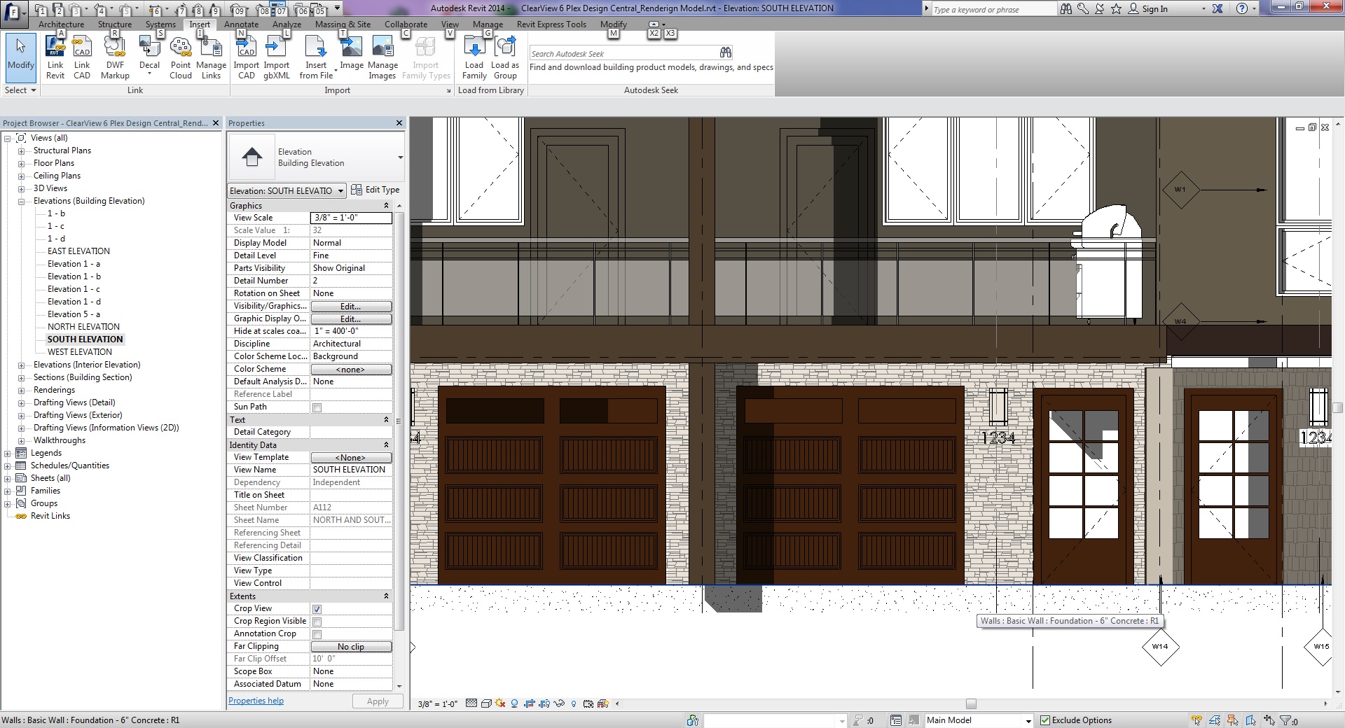

I have read through the posts but did not find one specific to this unless I missed it. I am editing a garage door family and for some reason I cannot window select the elements that I want to mass edit. The elements are lines so I cannot select all in view. Not that I would want to as I am creating interior panels.
The wall the garage door is on keeps getting selected when I window not the interior panel lines
Any ideas or direction would be helpful

Thank you wwhub. I have 2d lines to represent panels within the door. I have created one set and I wanted to highlight the entire panel to multiple copy.
When I try to window the panel it selects the extrusion behind. If I pin the extrusion it still selects. I have attached the south elevation

Sorry I wasn't clear on the attachment. The elevation was only for reference for the garage door family inserted into my model.
I am editing the door sweeps and extrusions within the family not the model.
Within the family it won't let me window.
