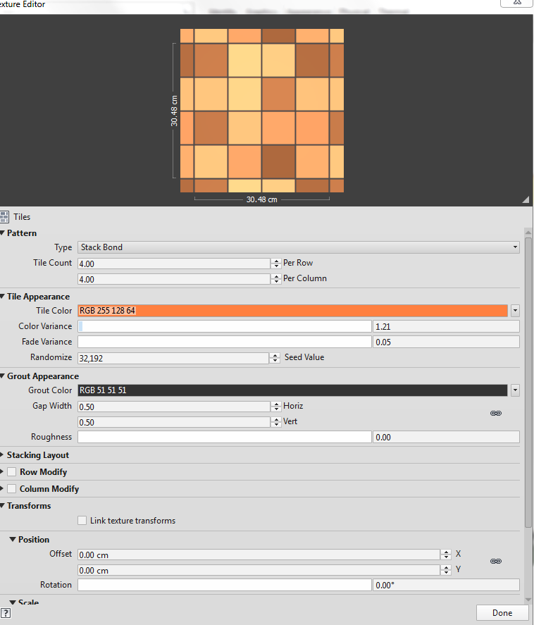

in case you are trying to colour a tiled/paved area with random colour(tones) that mac a certain spectrum...
REVIT CAN DO IT FOR YOU AUTOMATICALLY!!
dont use any other method
when editing your material-CREATE A TILES 'COLUR'
 note that when creting tiled texture, under the Texture editor you can randomise the tone factor- thus creating variations of tones between the tiled surface\see images for explaination
eli
