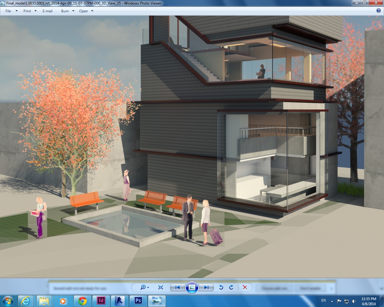

hi all, i have been trying to do my rendering in cloud, i set a floor under my building and set the texture to grass, when view on revit (realistic mode) the grass texture just can't be fully filled on the floor i created, and i tried to render, there are those strange white-shadow-ish stuff on the grass with some grass visible, i checked the lighting, which i picked "external: sun & artificial" with no time constraints, anyone encounted the same problem before and know the solution? thanks!

Raise the grass floor you made up 1/16" or higher.  You have two planes trying to co-exist together.  That is my guess.
