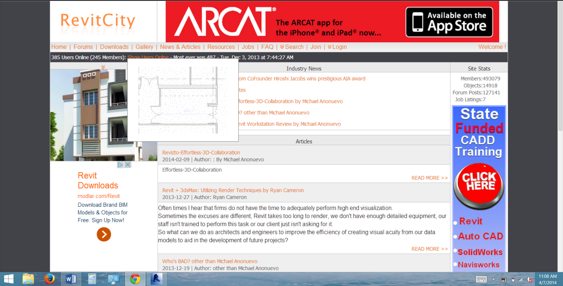

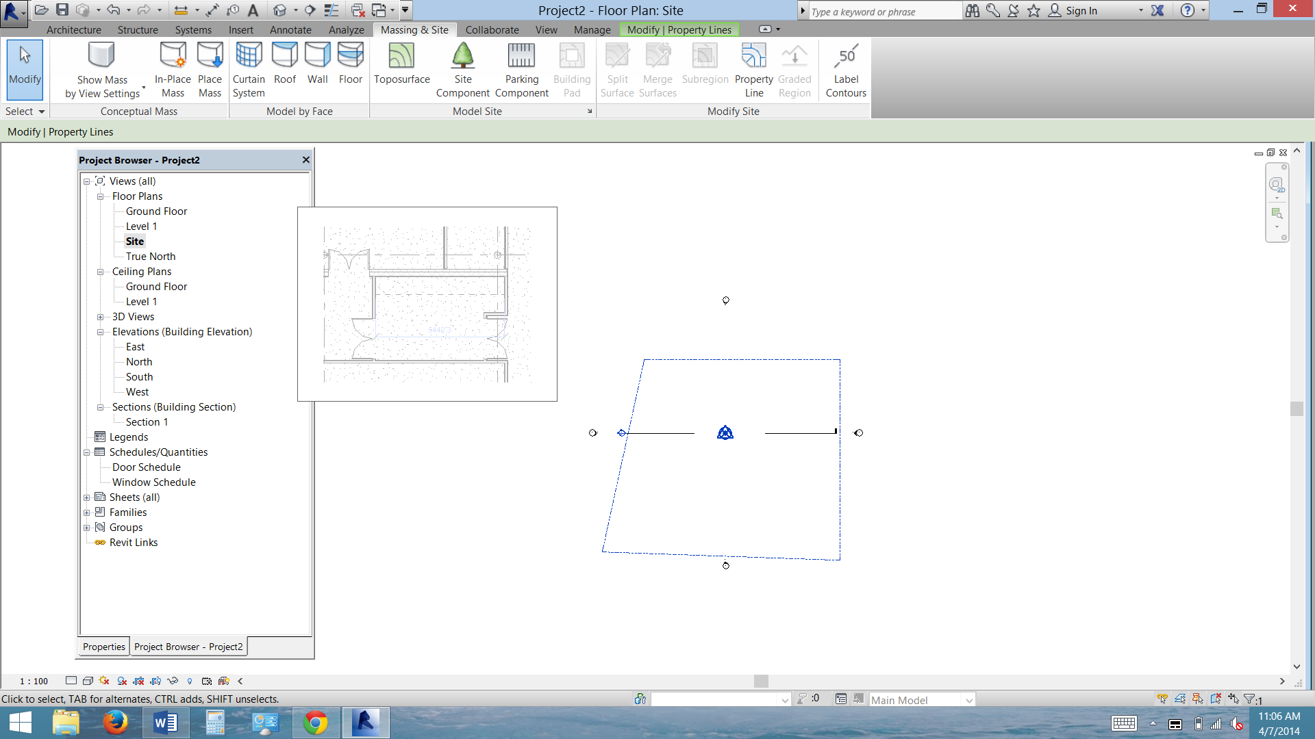

The tip boxes that pop up when you hover the mouse over a command on the top bar do not disappear after I move the mouse away. The box remains frozen on my screen and I cannot click on anything behind the box. The remains frozen on my screen even when I minimize Revit and remains in the screen even when using other programs. (See pictures). The box only disappears after I completely close out of Revit. This happens most of the time when the pop up help boxes come up, but occasionally it disappears after I move away the mouse. How do I get rid of the box when does not go away?
