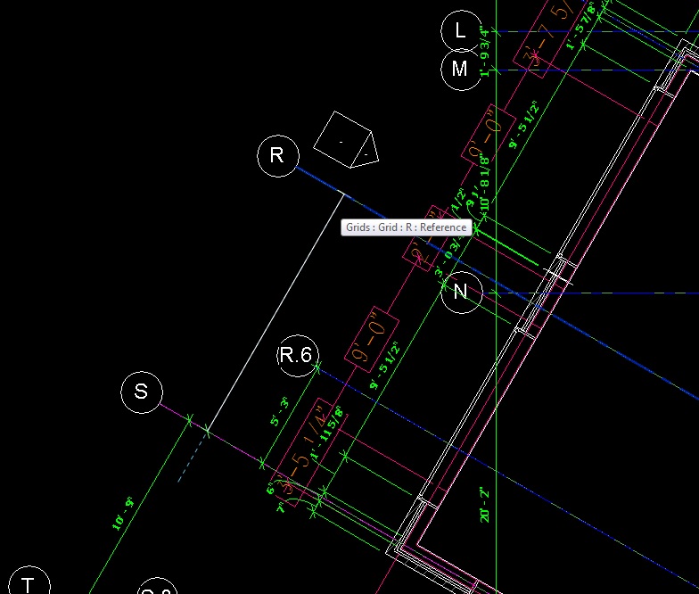

Ok so I am trying to dimension a floor plan, and I am using an Aligned dimension and no matter what i do once I click the second reference point revit dosent create the dimension.
I have an underlay with a cad file could that be the issue?  I make sure the actual revit gridlines are being selected and nothing happens. i actually tried the linked cad file also and no luck.
What is going on ? Why is it so hard to dimenions something on a 30 degree angle....?

i thought maybe they could be slightly off parrallel but revit would recognize this and give me a warning.

The CAD file is the issue.  Did you trace it?  CAD is defined differently then revit and parallel lines may not be truely aparallel as revit requires.  I always recomment that you never trace CAD but that you use it for a Reference drawing each line - wall truely parallel as revit requires for dimensioning.

but tracing is so nice!  i can do a layout in CAD so quickly, maybe it is just me weening outof the cad world and being rusty in  Revit.  Thanks WWhub.  that makes sense and I guess I will draw a drafting line and dimension to that.

i investigated the col lines giving me problems and yes they were  1000th of a degree off of 30 so once i selected the grid line i corrected it by typing in the exact 30 degrees on the witness lines.
and yes I agree with you, !  and it feels great to be back ! i can't wait to become a advanced user again as I once was.
